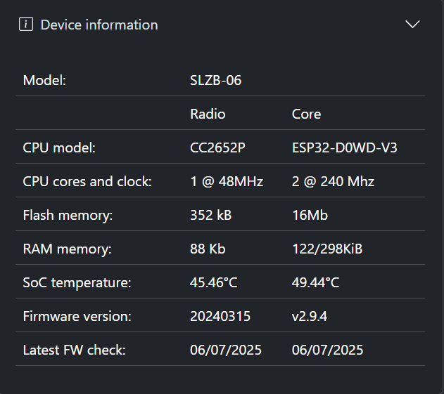

This is the info of the coordinator:
These are my settings:

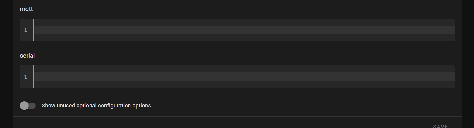

Set this :arrow_up: to false hereOn /homeassistant/zigbee2mqtt/configuration.yaml
If you fill out the configuration file via the addon, it grays out the manually configured fields.
From another thread I replied to

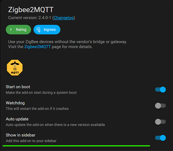

For Onboarding
  1. Place the Z2M in the sidebar to assist with onboarding
  1. Leave these fields clear in the Z2M config
  1. Start Z2M and then click the SideBar link, you should see the onboarding screen.
  2. Fill in your config data there.
Leaving the serial field blank did the trick.
I restarted Home Assistant and clicked in the Zigbee2MQTT in the sidebar and didn’t open the onboarding page, it went straight to the device page and could add successfully my first Zigbee device.
