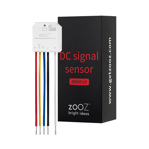

I’m gonna be honest and it’s looking that in the long term getting a zwave stick and installing this at every smoke alarm system you have will be the better long term solution:
Will this work if the power fails and the alarm goes to battery backup? This is a requirement in the UK.
One of the videos listed with it shows a test where they put in a dead battery as a test and it still working without false alarms, you will need to ask them if they can run a test with a power cut and see if it still works as it should:
