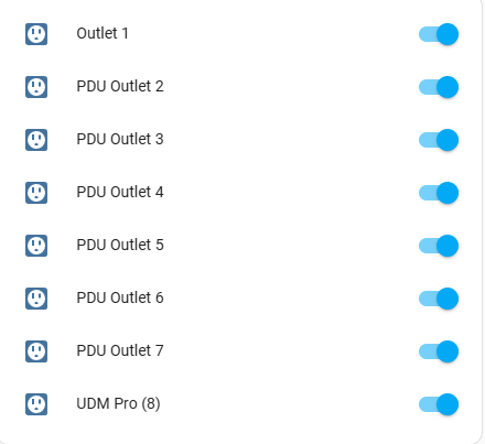

Instead of renaming all the entities, can set in customize friendly_name: Custom Name. This way can keep entity same name and rename as needed using a friendly name.
Here is example contained in my customize: in configuration.yaml
# APC Customize
switch.pdu_outlet_1:
friendly_name: Outlet 1
icon: mdi:power-socket-us
switch.pdu_outlet_2:
friendly_name: PDU Outlet 2
switch.pdu_outlet_3:
friendly_name: PDU Outlet 3
switch.pdu_outlet_4:
friendly_name: PDU Outlet 4
switch.pdu_outlet_5:
friendly_name: PDU Outlet 5
switch.pdu_outlet_6:
friendly_name: PDU Outlet 6
switch.pdu_outlet_7:
friendly_name: PDU Outlet 7
switch.pdu_outlet_8:
friendly_name: UDM Pro (8)
