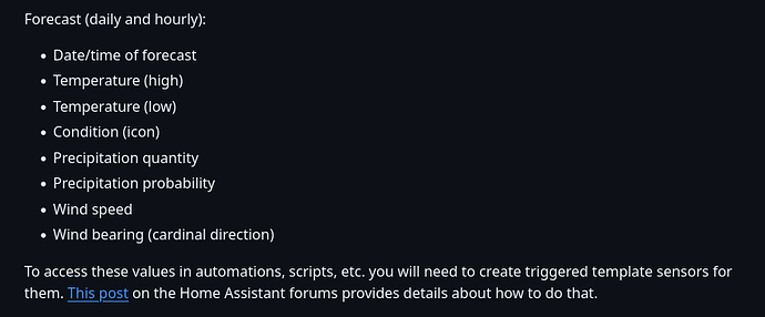

If it is the one by jaydeethree, its docs show the following:
The link in that screenshot leads to a post in this forum explaining the use of the weather.get_forecasts action.
