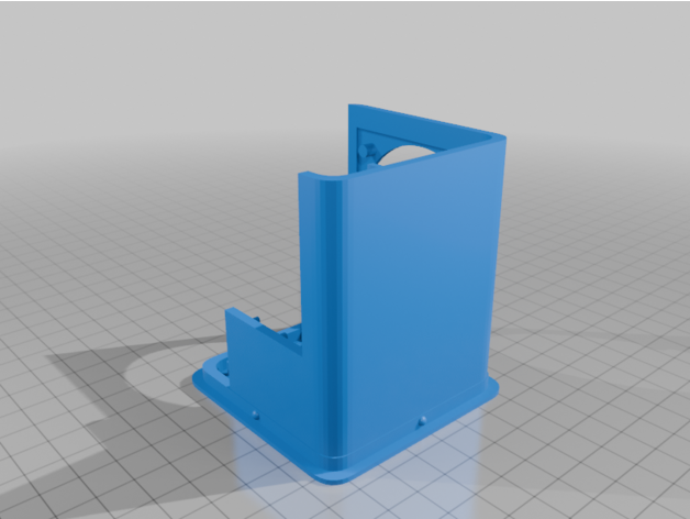

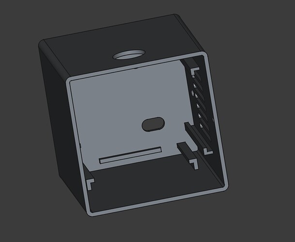

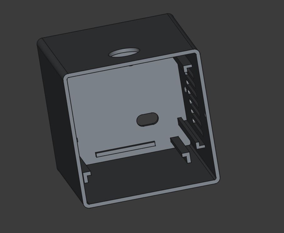

There is an update coming for the housing. I have been experimenting with an esp32-s3-devkitc-1 because of psram. Therefor the housing had to be altered. I took that chagen and created an inside that slides in the outer housing. It makes placing the components a lot easier, and if maintenance is needed, that is also a lot easier. So if you need to print, you can await that one.
I’m using a Xiao ESP32-S3 for the same reasons of PSRAM. I mounted everything on a 5x7 centimeter prototype board and like you, it slides in and out of the housing. I’m creating my own housing so it is also a holder/charger for my e-reader.

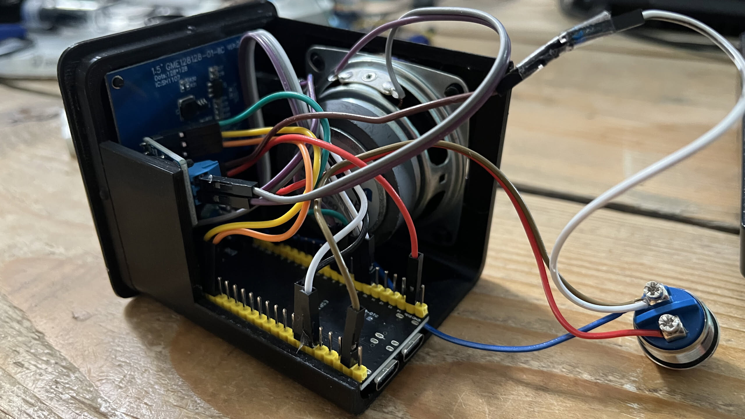

P.S.: @EnsconcE can you please post pictures from inside the device (have looked but havent found some).
Hi pOpY,
Here is a render from my case. I use a prototype board and it slides in the holder on the bottom. Same goes for the small speaker on the side.
I can only upload one image.
Eric

Don’t forget there is also a V2 housing:
As for the stored alarm sounds. It’s not possible to do this for the media player, but it maybe could be done for the speaker as your post implies. I had spare parts ordered to do some development, because i do not want to kill my production instances for obvious reasons ;). I dont know when you will get an update in regards to that.
And for the Photo’s, i only have V2’s laying around, does that fit your need?

Yes, V2 Photos would fit my needs.

This is my development clock. I hope this fits your needs
