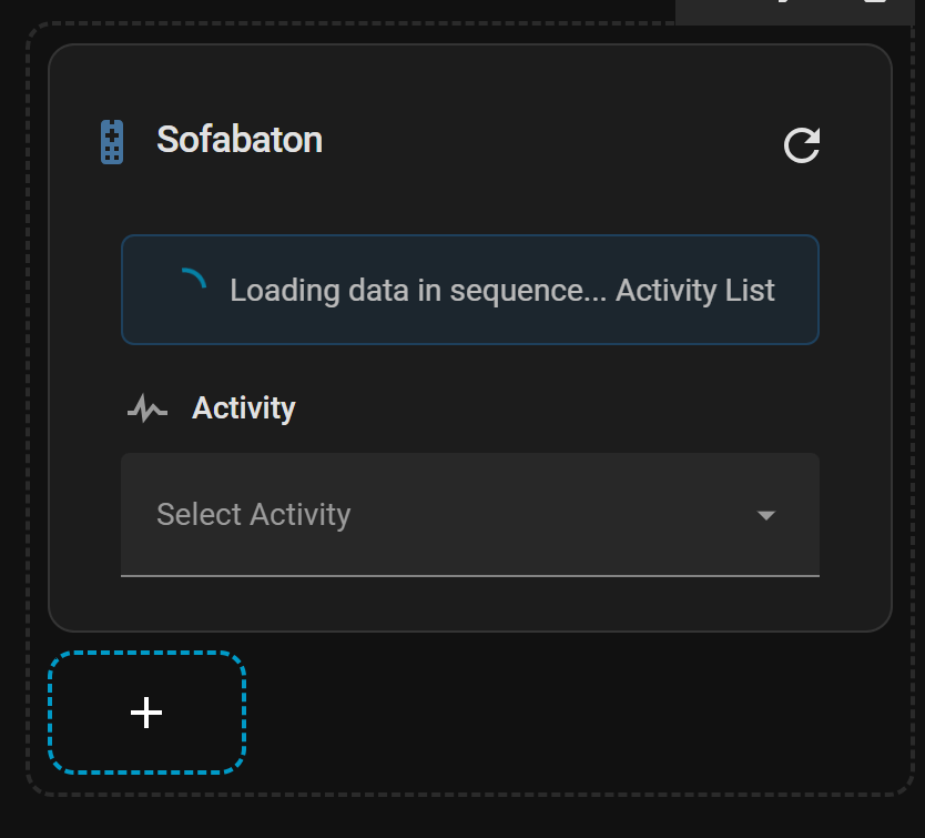

type: custom:sofabaton-main-card
entity: remote.x2_hub
On the right it’s spinning maybe because no activities yet?
