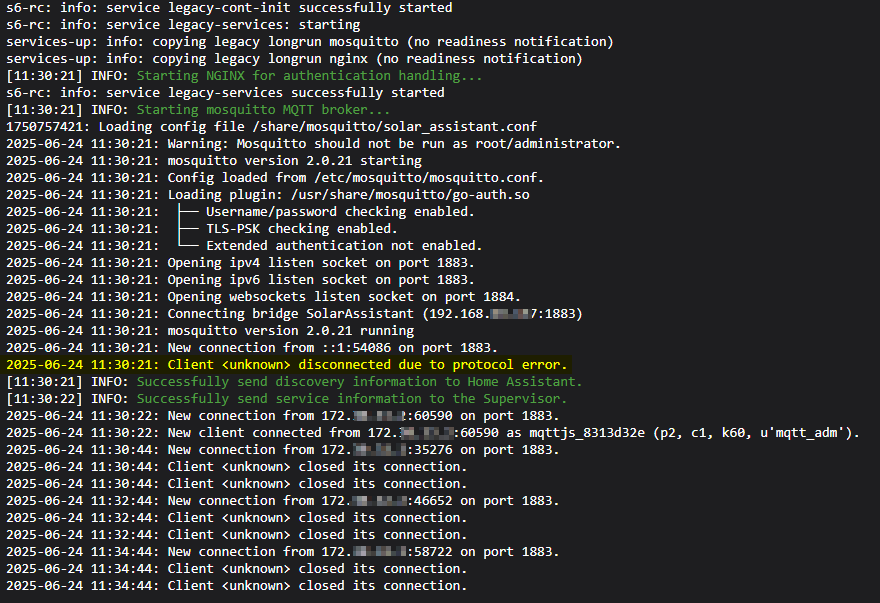

But i have a error : “Disconected due to protocol error”:
How can i solve that or where i need to search?

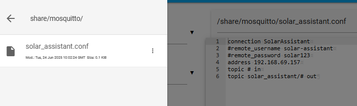

You have set in the folder
/share/mosquitto/solar_assistant.conf
connection SolarAssistant
address 172.xx.x.xx
topic # in
topic solar_assistant/# out
I put:
#remote_username solar-assistant
#remote_password solar123
address XXX.XXX.XXX.XXX
topic # in
Without the last line (topic solar_assistant/# out) …
but, after reboot services, it’s the same.

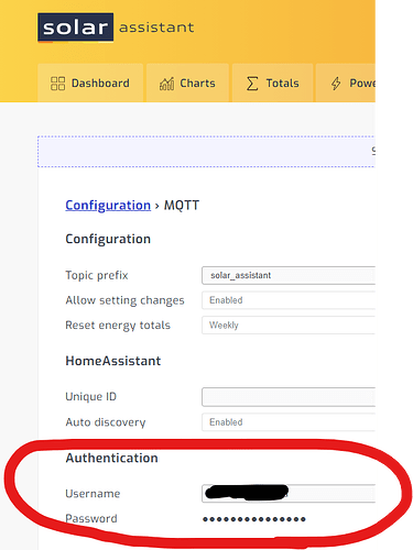

Since you did not configure the user/password in the solar_assistant.conf file, can you double check in solar assistant if you should have supplied it?
So, I tried adding the login/password. It didn’t change anything.

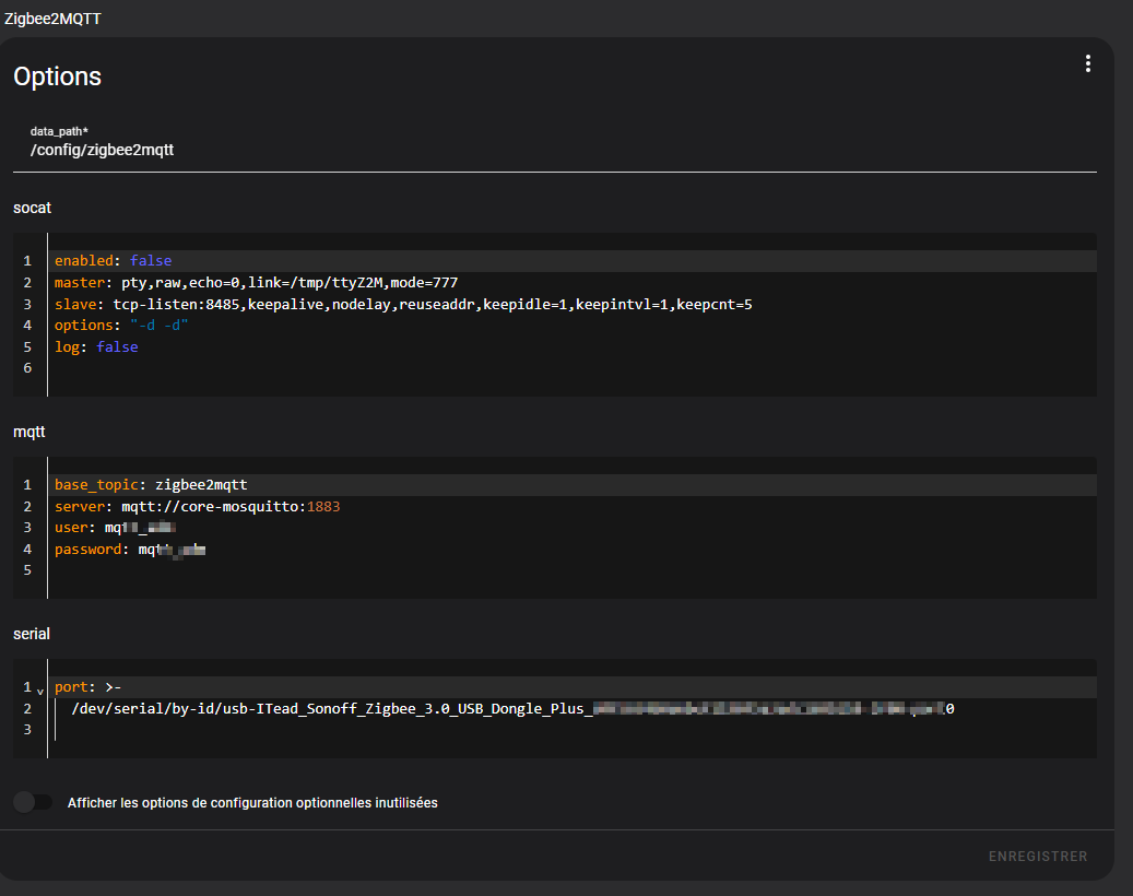

In Z2M I have the same user and password as the HA login.

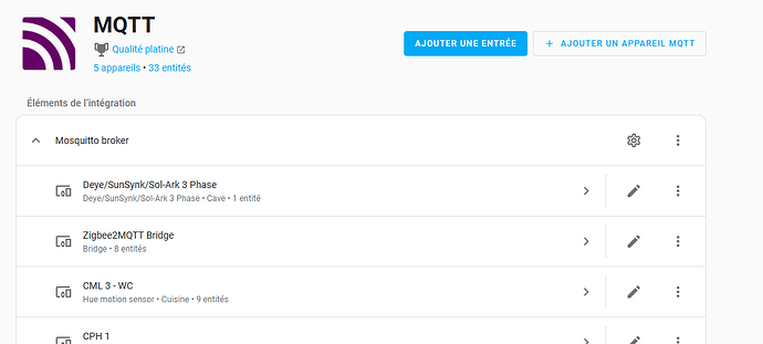

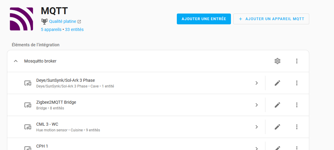

Hi all,

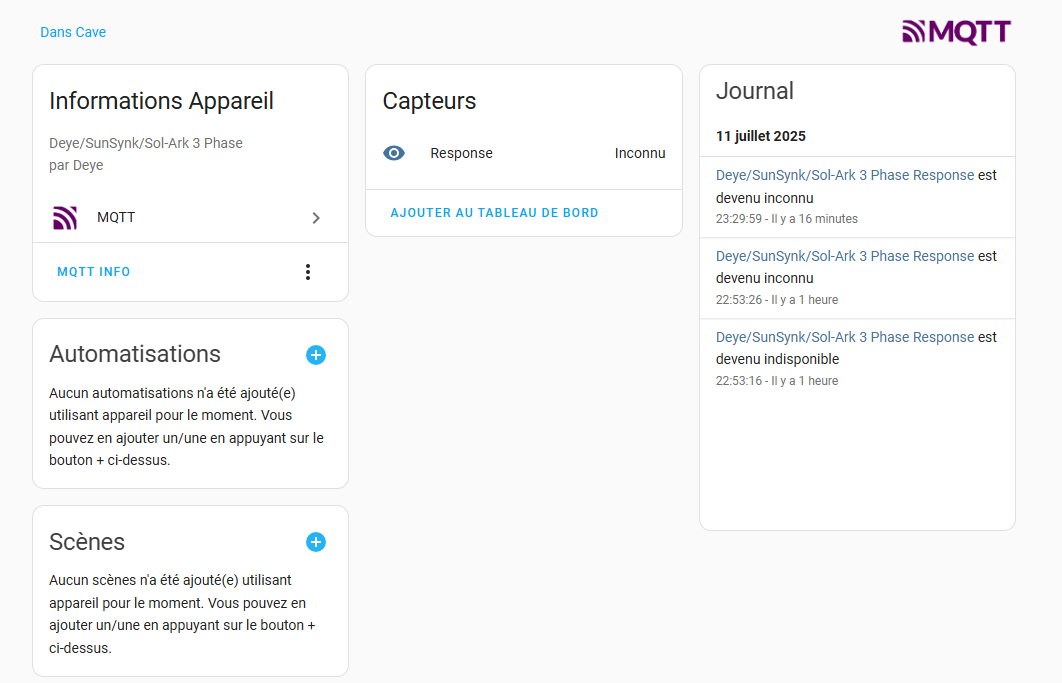

After reset all and install without log/pass, my SA is working but… i have no entity.

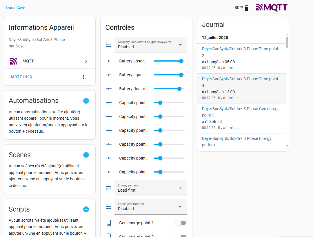

I see my DEYE:
But no entity is visible:

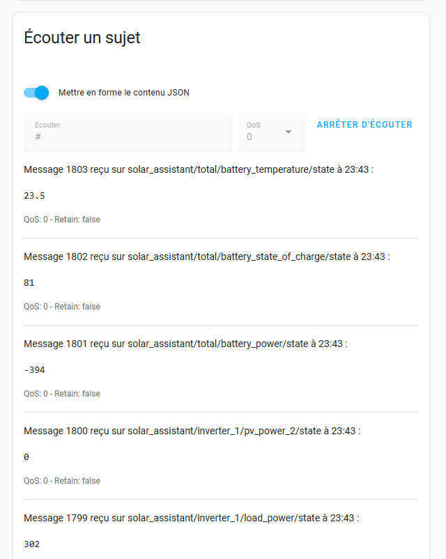

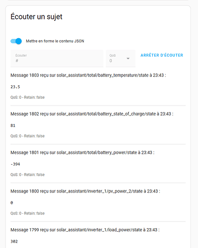

But when i listen, i have all what i need :
How can i create all entity?

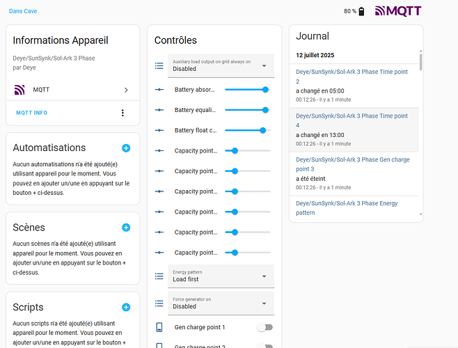

My Bad, i didn’t activate “Auto Discovery” in SA…
Now, it’s working :slight_smile:
