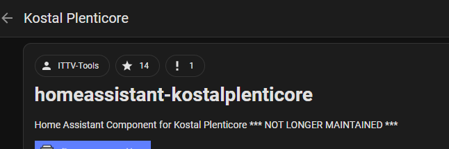

As anyone updated to 2025.1 and got the integration to work? I’ve loss all entities…
Anything in the logs? I haven’t planned to update to 2025.x for a while, but this confirms it
I am guessing the problem is that I was using an old but funcional HACS integration
That doesn’t work with 2025.1
The author replied that “I don’t maintain the Hacs integration anymore. There is a buildin integration that works fine. Please use that one”
But I cant install it.

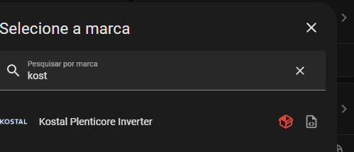

I’ve removed the HACS installation, removed the code from the configuration.yaml file, checked components directory (was erased) and when i go to add the integration, it shows the old one:
I think it’s de old one; if I try to install, I get “This integration cant be added from UI”.
I think the old integration is preventing the new one to appear?
If I try to install from HA site: Kostal Plenticore Solar Inverter - Home Assistant
It says that “This integration does not support configuration through the user interface. If you follow this link to the Home Assistant website, make sure you are running the latest version of Home Assistant.”
I dont know what to do…
Have you restarted HA?
FYI I have been using the official integration successfully for years
Same issue on my side. Just updated to 2025.1. Please help.
I managed to solve it by deleting the directory on custom components ( I had it renamed earlier)
