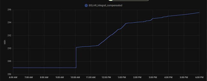

Though the values generated ending up in my power dashboard are quite accurate, there is an exception :
in the mornings , the first hour of the day, it generates a spike that makes no sense
in the picture above I would expect the first hour with sun to be less than 1KWh
a) why is this spike created?
b) how can I avoid it?
Regards
Ilias
Share the history graph of the power sensor.
How are you converting the power to energy for the energy dashboard?
Share the history graph of the energy sensor.

the raw input from the sensor is like this
and here the compensated one
You can’t just add attributes to a power sensor to make it an energy sensor. It needs to be integrated with respect to time. Feed your power sensor to this to get an energy sensor:
Use method: left
I had the integrator already in place, sorry i did not mention it.
So on the occasion of HACS not working after HAOS update to 2025.1, I had a look in the logs. I fixed HACS and I noticed my conversion to energy had a warning , I was using unit “W” while i had to use “Wh”. I changed this, I had multiple restarts due to 2025.1 updates and since then… it has been working excellently :
