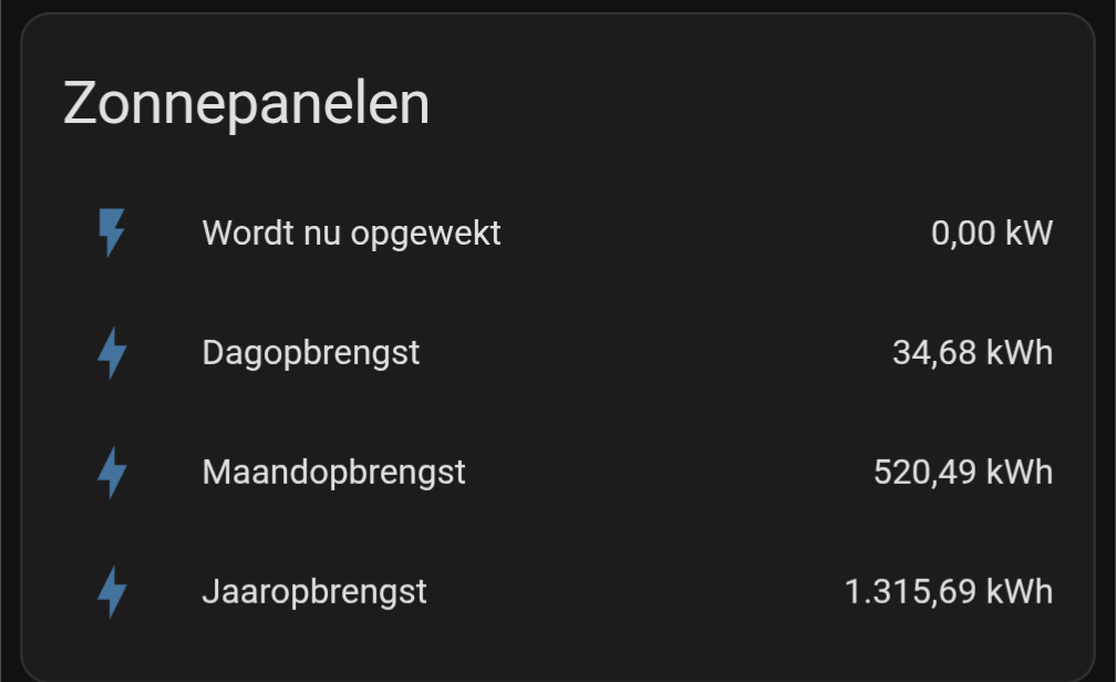

So on my main page, I created a card that gives a quick overview of what my solar panels are doing: daily power generation as well as current power generation. This works and is accurate with what the FusionSolar (it’s Huawei) portal is giving.

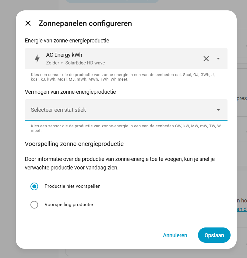

This is how I have it set up:
I have no idea if that’s correct because the documentation about this is, quite frankly, completely unclear. For the non-Dutch folks, the top field is filled in with the “daily generation” entity, the second field with the “currently being generated” entity.
Going off of the descriptors under the fields, my common sense is telling me that “currently being generated” should be in the top field, but that entity doesn’t show up in the dropdown list there, despite it meeting all the requirements when I open the support page that’s in that dropdown list.

I didn’t enter the second field and didn’t predict production:
What different values are you seeing in the overview? Screenshots of both your own and the energy dashboard would help.
What you added is mostly correct, the energy counter (top field) however should be the lifetime total, not jsut the daily yield. Usually your inverter exposes that sensor as well
I see it. Added second field too. That’s the current production. Now the graphic on the energy summary is also complete overhere. Thanks.

So these are the correct values:

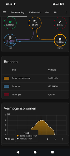

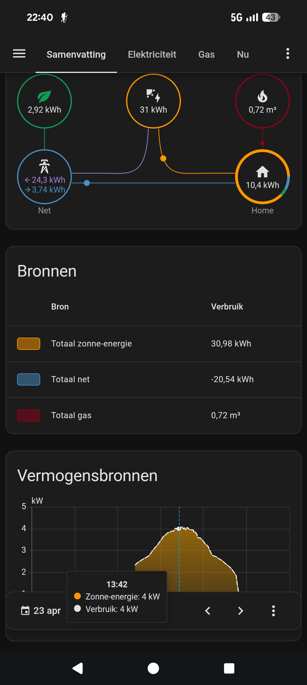

And what the energy dashboard is showing, is this:
Also the graph at the bottom consistently says that I used 100% of my generated power, but I’ve only used about a third of it today, so that info is also incorrect.
I tried changing the daily generated to lifetime generated, but it made no difference.
