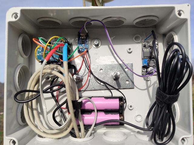

I wanted to measure pollution around me, so built a simple ESPHome based system with a nodeMCU, SDS011 and DHT22. To fuel it, I found a solar powered powerbank and printed a box for everything.
Unfortunately now it seems, although most of the day the battery pack is in direct sunlight, it is not enough to keep the battery full.

I build this configuration also and had the same idea, I found that the SDS and the Wifi takes quite some power. Depending on the frequency you could ESP8266 (I used a NodeMCU) into deepsleep. I kept is connected to a 5V adapter with a long wire.
For another project I used 4 x 5W solar panels but in reality they did not enough power to run during daylight a small blower and stay alive during the night. I choose to install solar panel on the roof en use 240V with an adapter

Thanks Eddy. Interesting to hear your experience. Didn’t think the sds was going to use so much. I’ll consider reducing the polling time and investigate deep sleep but likely won’t be enough. Unfortunately outside I don’t have the option to pull a wire and measuring pollution inside defeats the purpose …
