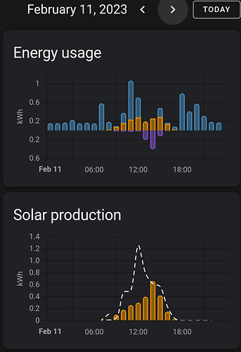

I took this screenshot yesterday, because I wanted to show it to my friend:
And this is from today (I viewed the yesterday data):
As you can see, the Y-axis scaling is wrong, it’s like doubled.
Is this a bug? If you are using forecast, can you please check?
I checked some prior days data, they also have wrong (doubled) Y-axis.

@tom_l Here is the oldest chart with forecast from 7 February, I think that was using Forecast.Solar. The scaling looks ok, I think. But, it looks like the forecast data are recorded in the history.
More forecast charts below. First I used Forecast.Solar. Then I switched to Solcast. Now, this might be related to the fact that I created 2 sites in 1 account in Solcast, but I don’t expect that would affect Energy dashboard Y-axis. Especially because on the day, the scaling was correct.

It’s scaling issue on the Y-axis of the Energy Dashboard. Just look at those two screenshots from THE SAME DATE (on my first post). The Energy dashboard shows it different.

Thanks, I think that might be true for Forecast.Solar, you don’t have history. I checked in the homeassistant database, and I found this:
So, I excluded sensor.solcast* in the recorder. Let’s see what happen in a few days, I hope they will be no longer recorded in the database. Wondering if I am the only one using Solcast :smiley: The lucky one with this issue :smiley:

And here was from yesterday:
And here is THAT day shown today:
The forecast chart is now gone when I view February 7. That was the oldest. So, it looks like rolling data of 7 days?

For unknown reason, the scaling issue seems to be fixed now. I didn’t change anything except excluding sensor.solcast* from the recorder database.
However, I still see past forecast graph older than yesterday. Sometimes I can see up to 4 days older, sometimes 7 days older. It’s weird, but I will accept it. It’s too difficult to debug this with my knowledge.

With the forecast for a second installation, the y-Axis is apparently messed up: as you can see clearly, the forecast from the first image is now on the wrong scale in the y-axis where it should not exceed 0.3 kWh. However, it is above 1.4 kWh.
I will wait and see how it appears tomorrow, but could be possible that there is something wrong.
