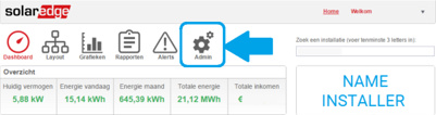

For some reason I don’t have the “admin” tab when I log on the solaredge site. I only get “dashboard” and “layout”.
I’ve asked my installer why I don’t have the other tabs like in this Google image
The installer was here today and we got a fresh API but I still get the same error. The api and site id have been checked and double checked.

I finally got it working a couple days ago thanks. After several back and forths my installer gave me his login details so I could do it myself and it works now, you have to save the solaredge settings page after each new api request which I guess he probably wasnt doing. Anyway it worked straightaway once I got a new API.
