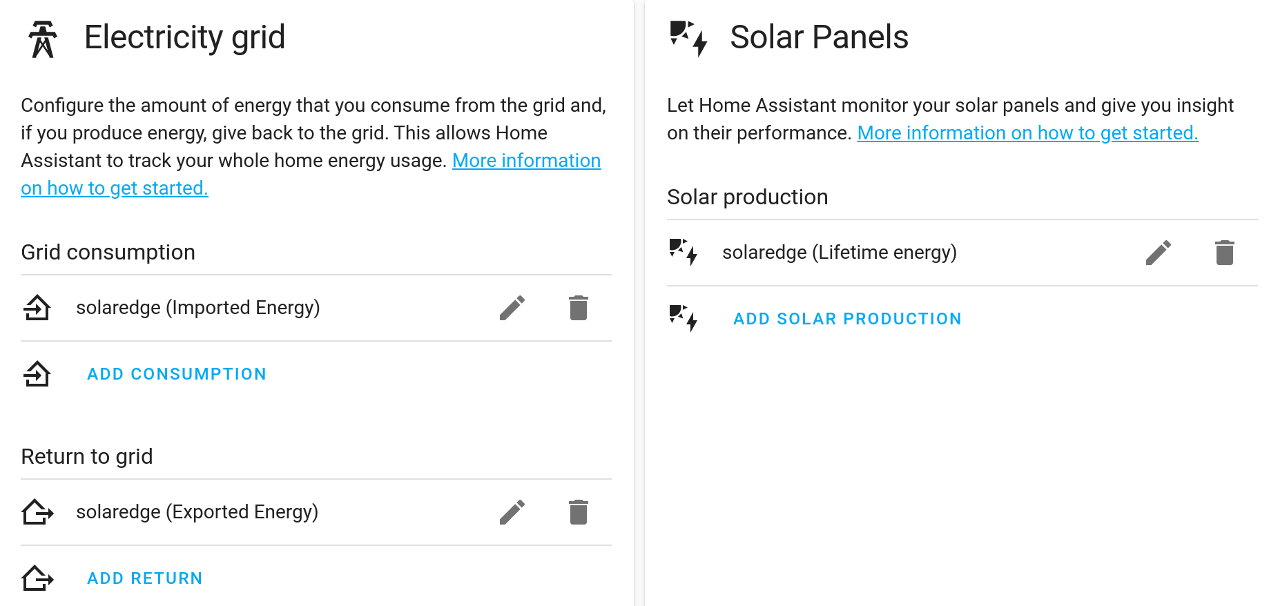

Energy Dashboard Configuration
As of Home Assistant 2021.11 the SolarEdge intergration can natively populate the Energy Dashboard without additional setup. (no need for Utility Meter or other workarounds)
When you upgrade to 2021.11 some sensors may be set as unavailable and you may need to enable them to function correctly. Please refer to the Breaking Changes for 2021.11.
My Energy Configuration
To monitor your solar system you can utilise sensor.solaredge_lifetime_energy for solar production:
If you have a consumption meter in your SolarEdge system you can utilise sensor.solaredge_imported_energy and sensor.solaredge_exported_energy for energy to and from the grid:
The results should appear in two hours in My Energy Dashboard.
