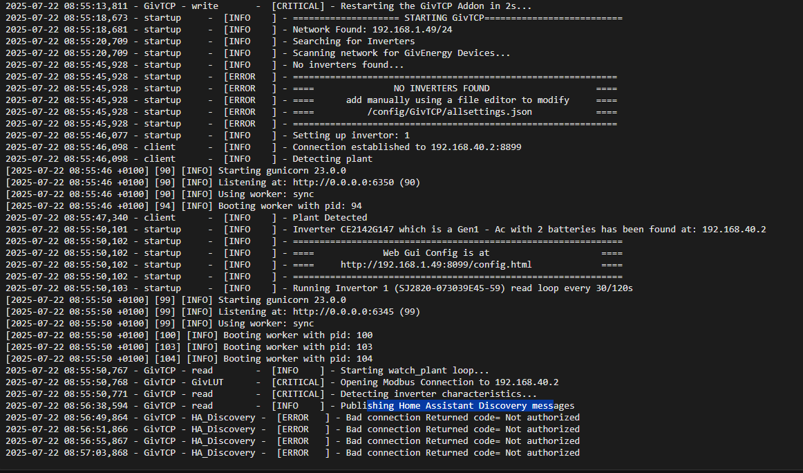

I started to have issues my home assistant that the supervisor would not start or my GivTCP hangs, so I have been repeaty rebooting my system, and so far I have been lucky, but in doing so I have lost a lot of data. so I have chosen to rebuild the environment, but here I have run into a few issues
is that when I install the givTCP and put in my details for my inverter, with an ip address of “192.168.1.7” and my Invertor is located on a vlan with a IP address of “192.168.40.2” the givtcp addon can’t see if
so I have gone to the file, and I am confused, I have one invertor, and two battery’s – can some one please help me fill this in.

and I am getting the following results

EDIT: I see it has discovered an AC3 and 2 batteries. Have you got a SolarEdge as well ?
Also, I think you need to set up the username and password for MQTT, that’s probably what the errors are at the end of the log

ok I have the GivEnergy finding and reporting information, but no saving it, which is not a big issues at the moment as I want to get everything talking, plus I need to go and refresh my knowledge obn how to do this.

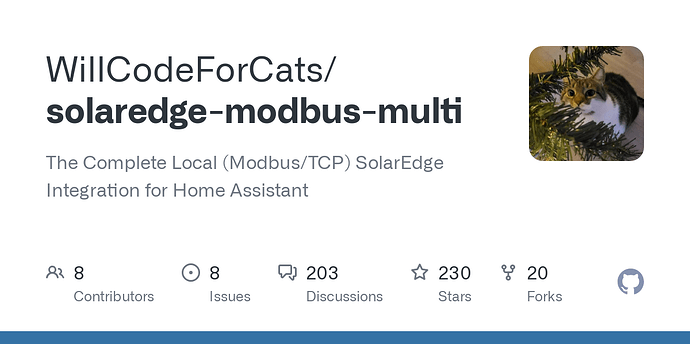

The solaredge_local integration is useless now because SE blocked LAN access to the inverter’s internal web server. I don’t remember which FW version did this but it was many years ago.
The only option for local access now is Modbus, which I recommend my integration: GitHub - WillCodeForCats/solaredge-modbus-multi: The Complete Local (Modbus/TCP) SolarEdge Integration for Home Assistant
