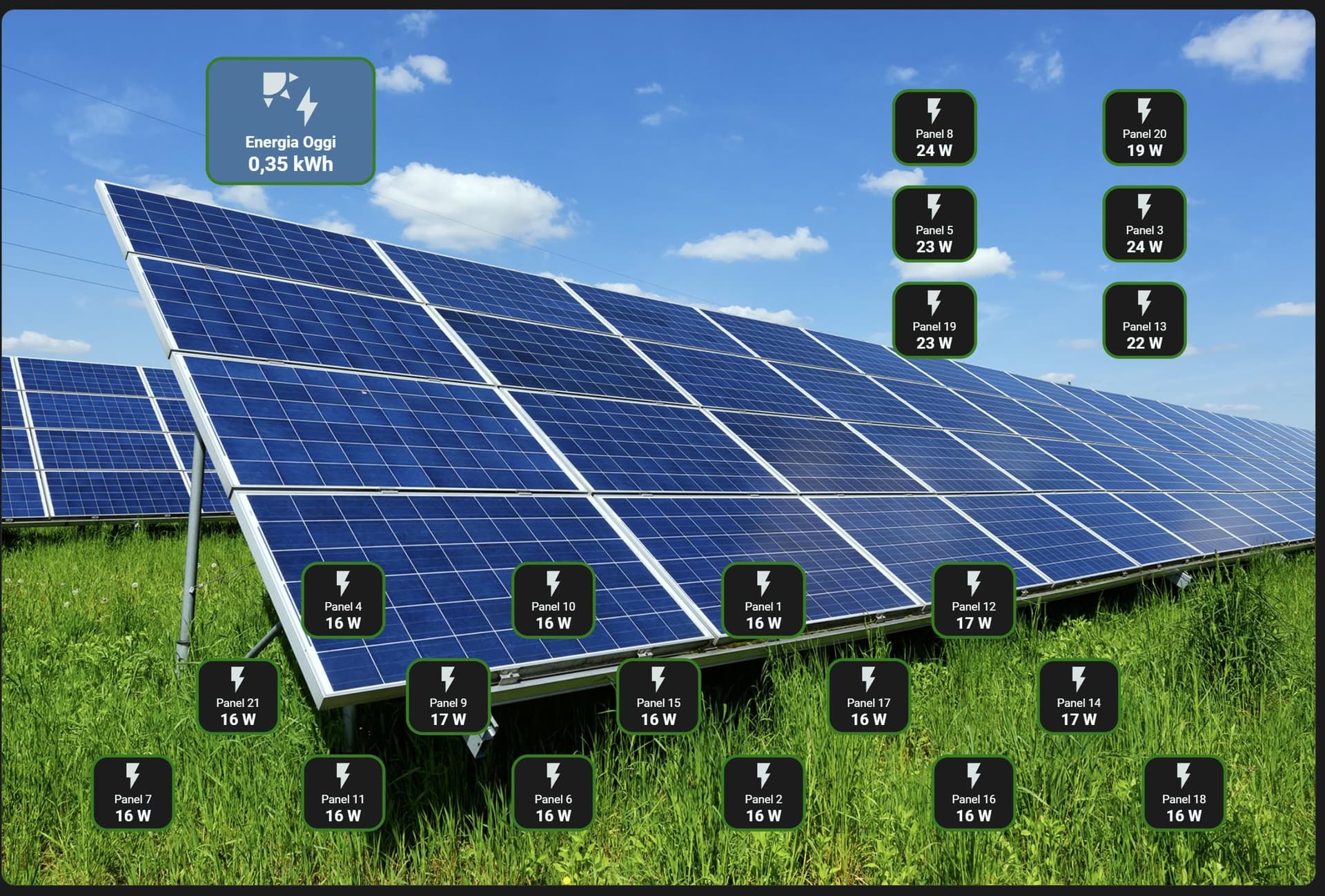

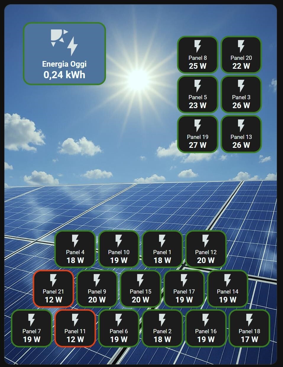

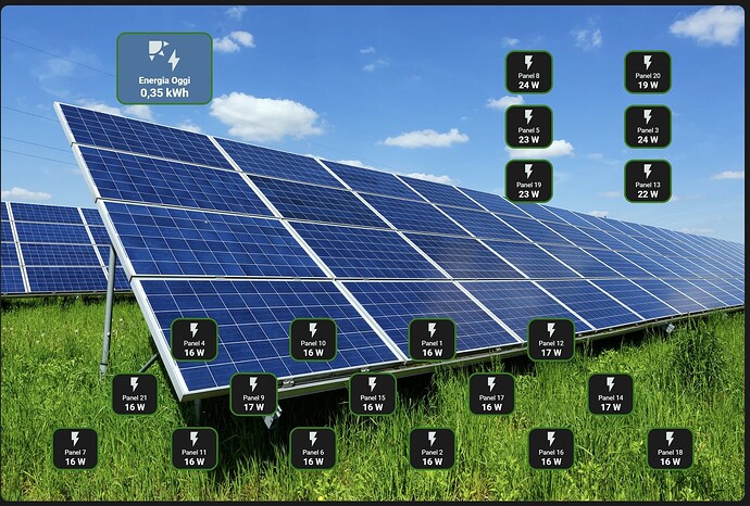

Good morning, I’m trying to replicate the SolarEdge website monitoring screen on Home Assistant.
I managed to create a tab that more or less mirrors the layout.

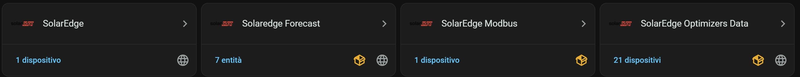

I have four SolarEdge integrations.
I can get the total daily production.
I can get the instantaneous production of individual panels.
But I haven’t been able to find a way to get the daily production of individual panels like on the SolarEdge website.
Does anyone know how to get the daily production of individual panels?

Yes, I know the difference, but the tab doesn’t show me any other values ​​at the moment. Unfortunately, it updates every 15 minutes.

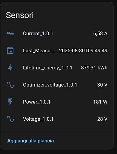

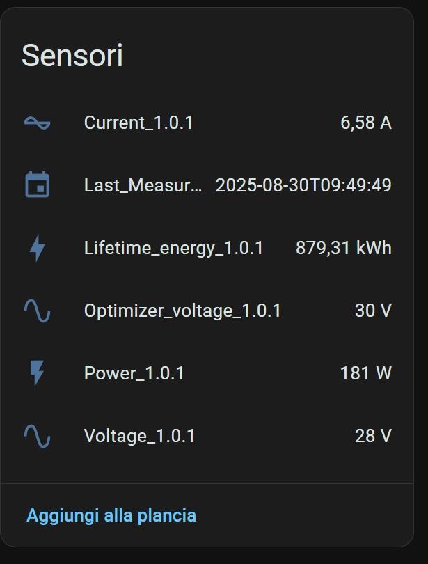

I use two custom integrations to communicate with our SE system.
  1. The excellent Solaredge Modbus Multi
  2. This one for Panel Data
The panel data one even has it’s own dashboard
