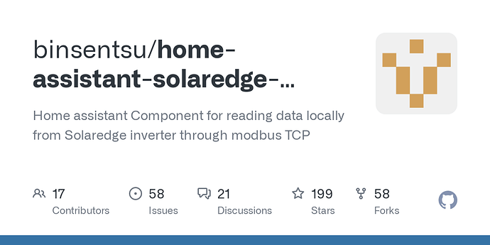

There are a few integrations on hacs. Which you can choose from.

If I were you I would check, it can be that you are correct, but I know for a fact that for some models the claim to be cloud only, still you can activate local modbus using

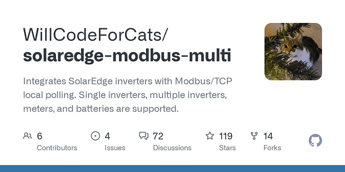

Modbus works fine locally. This is my integration I developed and use on my home system. You do have to go into the inverter to enable Modbus connections first.
