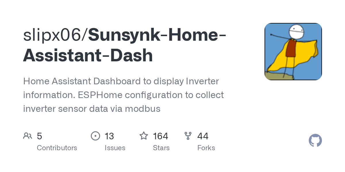

here’s a similar discussion thread - I use the repo I mentioned at the bottom with an m5 stack + rs485 tail (powered from the 12V inputs of the solark itself) and it works great for reading and writing values
A new active developed solution for integrating Solarman data collectors used with a variety of inverters
inspired by StephanJoubert’s integration.
It supports WIFI and LAN logger!
This might be interesting for those who using currently Solarman integration for Ethernet LSE Stick Logger
Home Assistant Dashboard to display Inverter information. ESPHome configuration to collect inverter sensor data via modbus

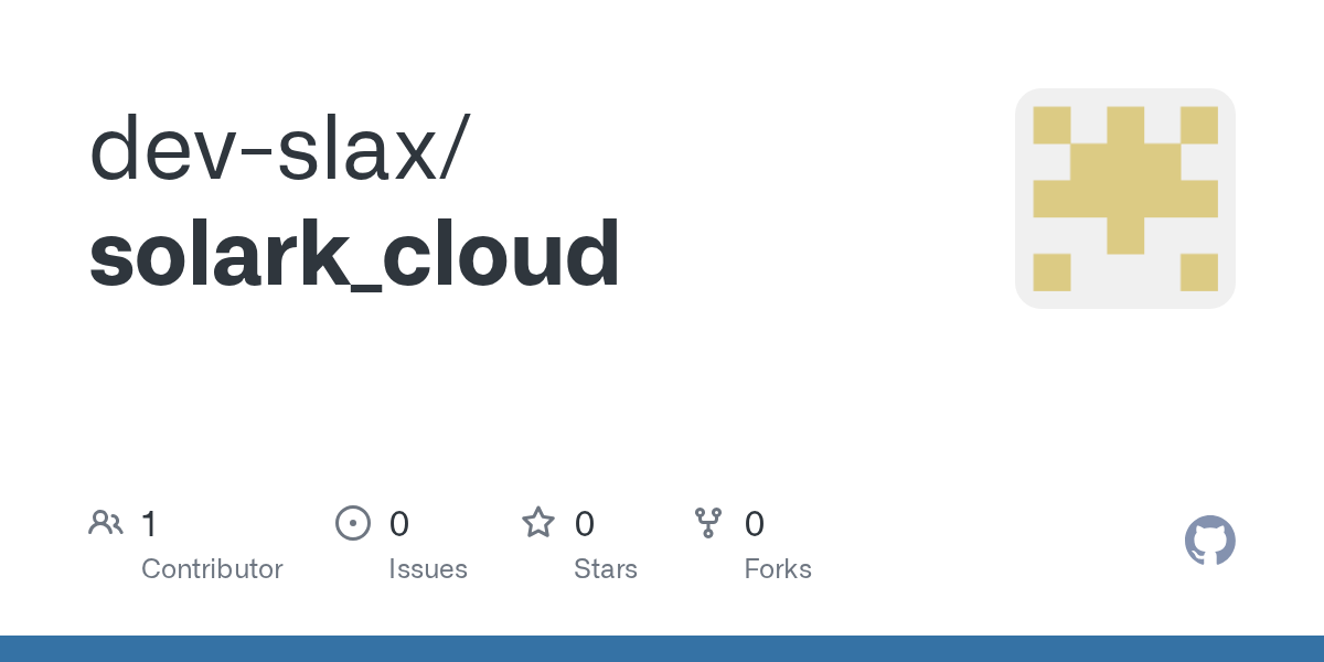

If you’re okay with just using the website. There’s this integration :
Contribute to dev-slax/solark_cloud development by creating an account on GitHub.
It uses the mysolark website to get the data.

Works perfect for me as well!
