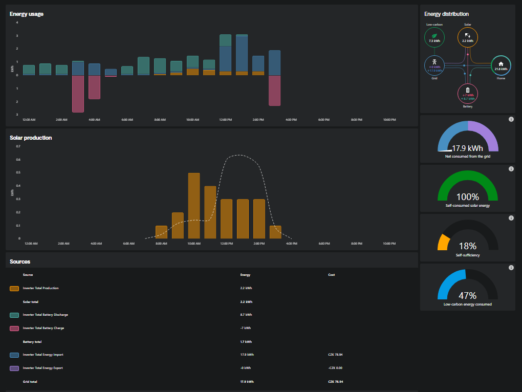

⚡ Solarman Stick Logger by David Rapan
Of course you can…
…and much more: Dashboards · davidrapan/ha-solarman Wiki

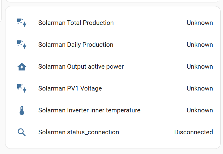

Hi, i have a Sofar solar 2700tl-g3. Running a while now in Home-assistant with the integration of StephanJoubert. And maybe i will switch to your version.
My inverter will switch off when the sun is down, will this a problem with your integration?
Now when i write this, the sun is down, and the integration looks like this.
Can you help me to solve this problem, please?
Not w/o debug log.
Now when I write this, the sun is down, and the integration looks like this.
That looks about right (If the values ​​appear in the morning w/ the sun). But I have to say that those sensors do not look like they are from my integration. :wink:
