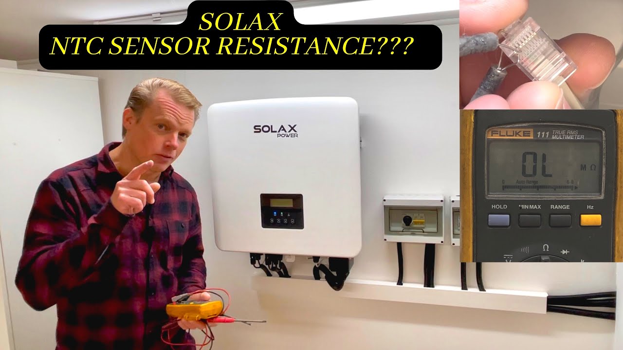

I find the answer on this video.
NTC is connected on pins 1 & 3 of the RJ45 and the value is 76.1 kohm
