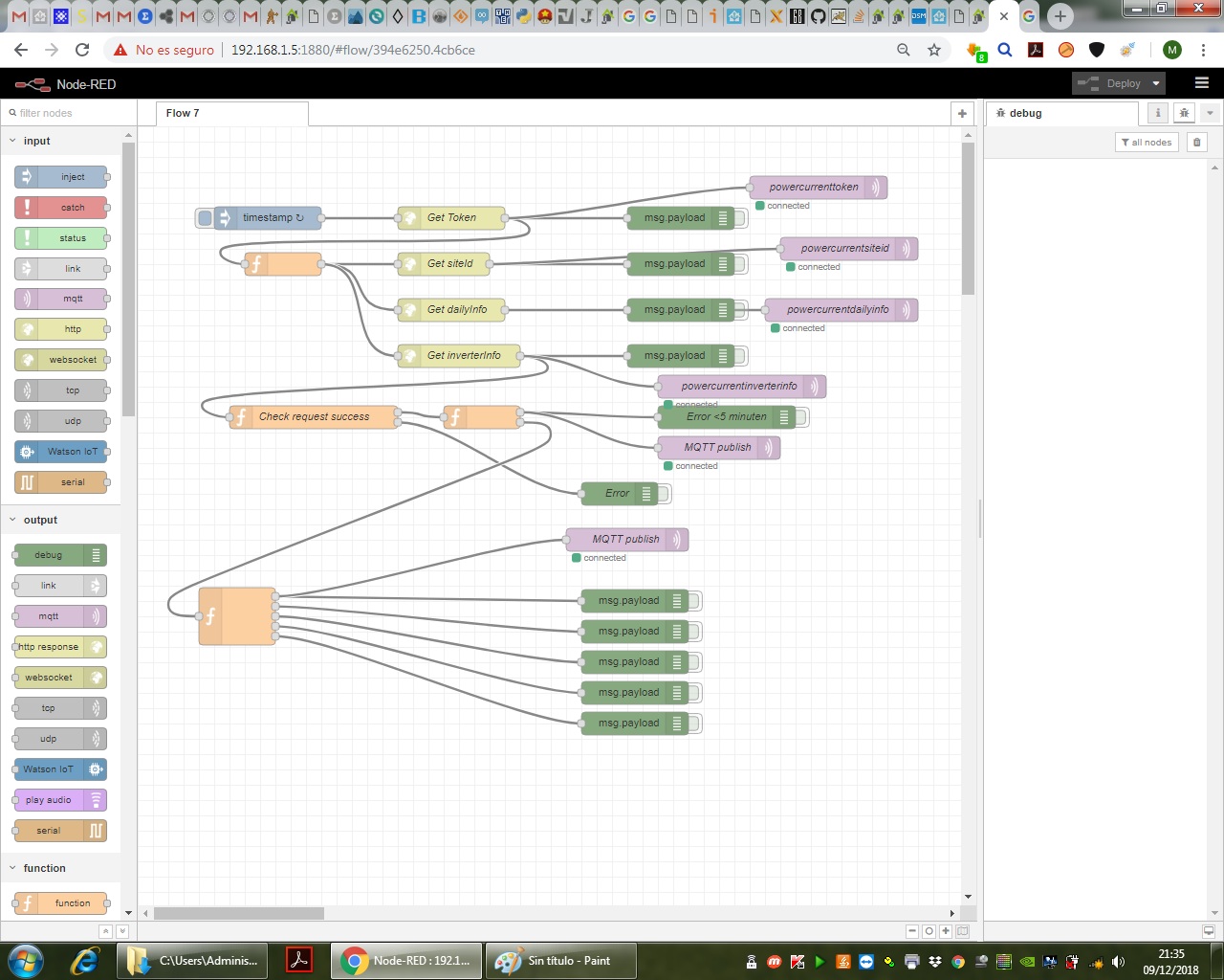

Yes, I think I get the error on the Get inverterinfo.
As you can see in the screenshot, my flow is the same from rtenklooster, where I deleted the influxdb and server nodes:
I customized the node info with my:
USERNAME : the username for the solax cloud site
PASSWORD: the password for the solax cloud site
InverterSN: you can find this serial number on the solax cloud site
WifiSN: the serial number of the WiFi dongle (printed on sticker)
I didn’t replace the SITEID on Get inverterinfo node, because I don’t know where I can find it.
I don’t need to use grafana or publish the data in HA. As you can see I can send the data to Jeedom, so in enough at the moment…
NOTE: the code of my Get inverterinfo node is: 47.254.152.24:6080/proxy//mysite/getInverterInfo?siteId=MYSITEID&tokenId={{{tokenId}}}

@dj_janker
when you do a debug on Get siteID you see “siteIds”. this is your number you have to fill in. Not siteId
under result - 0 you see siteIds
