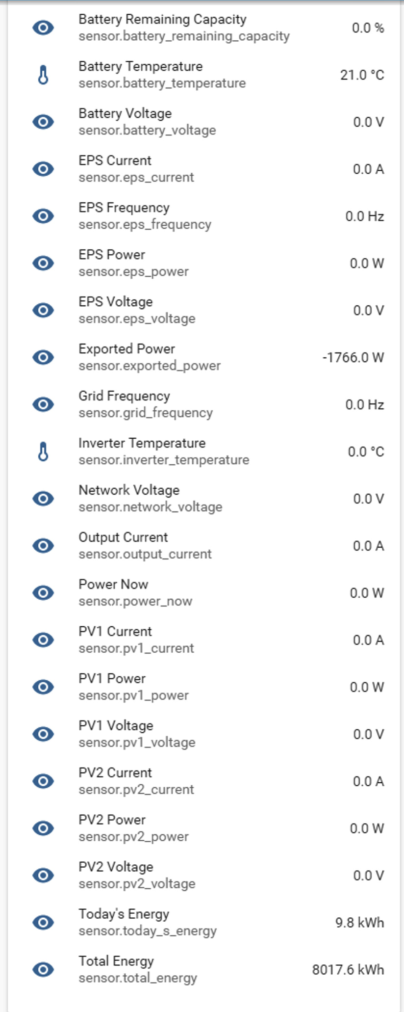

This seems to have worked for me out of the box directly to the inverter.

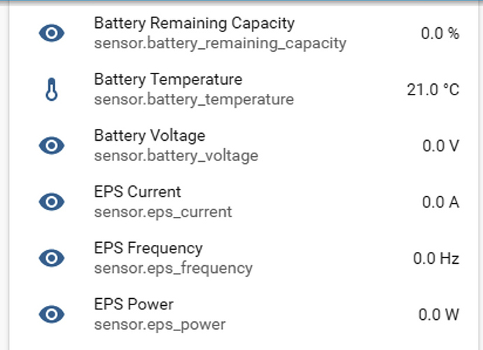

The values I’m seeying are all 0’s except total power, and the export figure. Not sure why that is though.
I can’t compare this to the more manual way though, this was the first time I have set it up.
Is anyone else experiencing 0’s throughout? I get 0’s on the online solax-portal.com site too, so at least HASS is showing the same as the portal. Just need to figure out why they’re all 0.

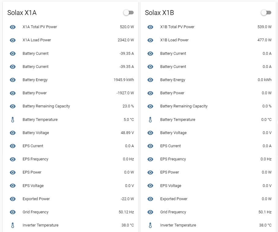

I do get one odd reading as its showing sensor.battery_energy in kWh and looks like it is reading my yearly generation rather than the actual battery energy - I would love to have 1945.2 kWh in my batteries
Other sensors seem to be correct and looks to be polling around 30secs rather than what I have in node-red at 60sec

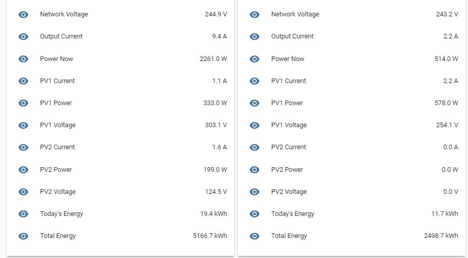

On the thought about multiple inverts, just add the platform in with the second inverter details and it will create all the same sensors but with a “_2” at the end - Would be grate if we could use name: in the platform (Will test and update)

Same works for the templates, create multiple templates with different names based per inverter (I used _2) and just add “_2” after the sensor’s in vlaue_template as below
platform: template
sensors:
total_pv_power:
friendly_name: “X1A Total PV Power”
unit_of_measurement: ‘W’
value_template: “{{ (states(‘sensor.pv1_power’) | float) + (states(‘sensor.pv2_power’) | float) }}”
load_power:
friendly_name: “X1A Load Power”
value_template: “{{ (states(‘sensor.power_now’) | float) - (states(‘sensor.exported_power’) | float) }}” -
platform: template
sensors:
total_pv_power_2:
friendly_name: “X1B Total PV Power”
value_template: “{{ (states(‘sensor.pv1_power_2’) | float) + (states(‘sensor.pv2_power_2’) | float) }}”
load_power_2:
friendly_name: “X1B Load Power”
value_template: “{{ (states(‘sensor.power_now_2’) | float) - (states(‘sensor.exported_power_2’) | float) }}”
