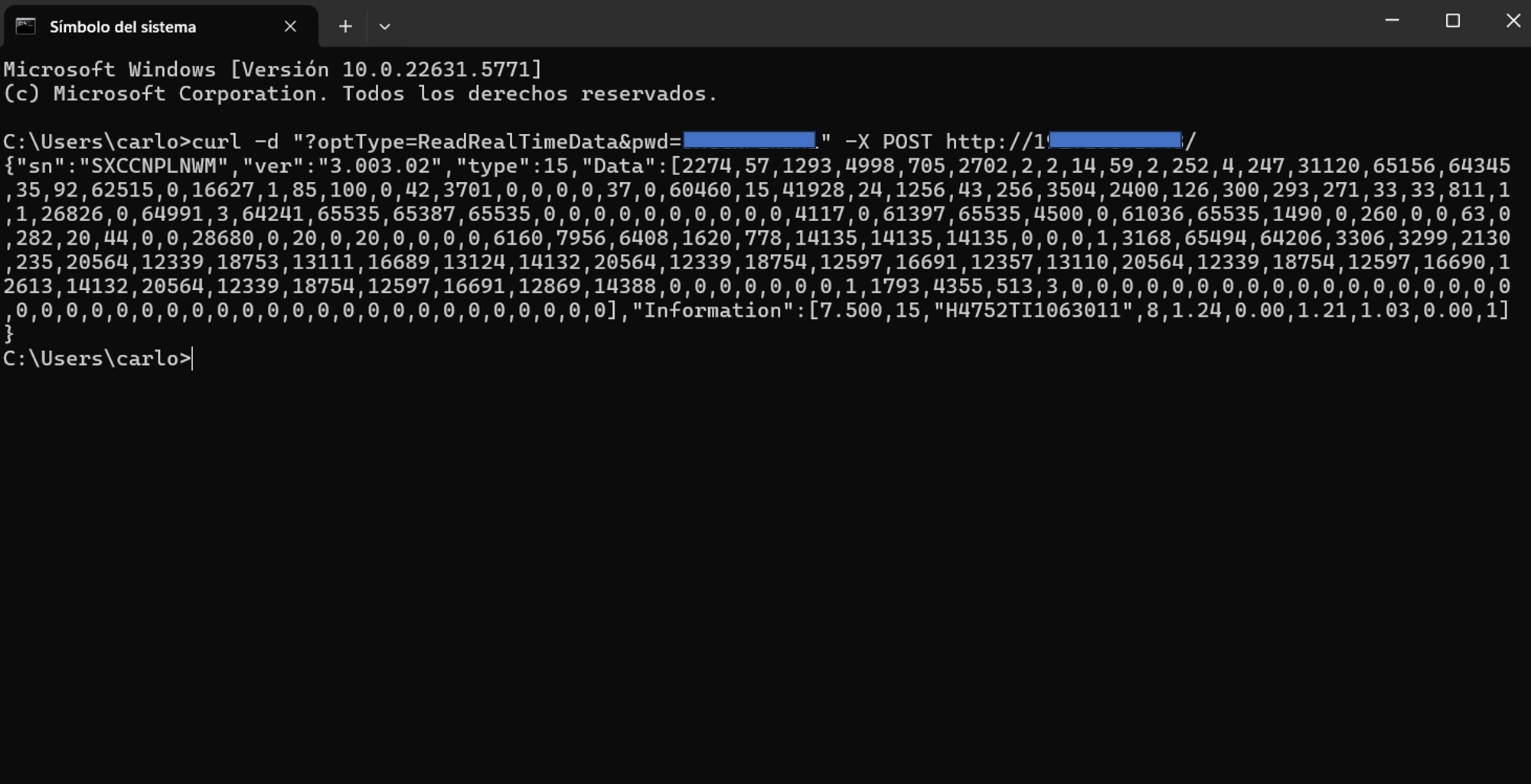

Hi I have just got solax X3 G4 with wifi 3.0 module with version 3.015.02 installed in my home. It has separate wifi to connect to device locally via solax app.
Home assistant default solax integration works out of the box from the home default wifi and I don’t need any reverse proxy raspberry to get information from separate wifi. Why is that working so easily as I read that it would need reverse proxy solution. Should I disable updates to my wifi module somehow?
Edit: shared same question in original python repo: Question: why is it working without wifi proxy solax x3 hybrid g4 with wifi 3.0 ¡ Issue #173 ¡ squishykid/solax ¡ GitHub

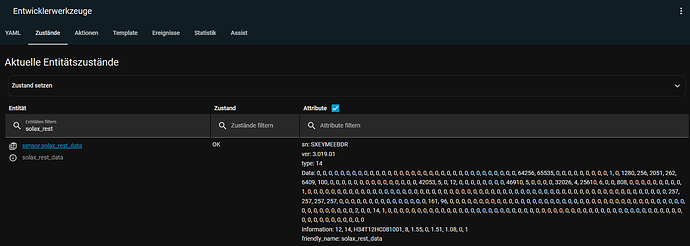

My output from the solax_rest_data sensor is the following where line 26 holds value 136 which seems to possibly be my yield?
The templates.yaml file also says I need to adjust customize.yaml but with what?
My type is 7 (X3-MIC/PRO)
sn: SXQCxxxxxxx
ver: 3.018.03
type: 7
Data:
  - 2353
  - 2344
  - 2349
  - 4
  - 5
  - 5
  - 0
  - 0
  - 1
  - 3158
  - 1980
  - 1
  - 2
  - 26
  - 25
  - 4999
  - 4999
  - 5000
  - 2
  - 45634
  - 1
  - 136
  - 0
  - 0
  - 0
  - 0
  - 0
  - 0
  - 0
  - 0
  - 0
  - 0
  - 0
  - 0
  - 0
  - 0
  - 0
  - 0
  - 0
  - 0
  - 8
  - 0
  - 0
  - 0
  - 0
  - 0
  - 8
  - 4000
  - 0
  - 32
  - 0
  - 0
  - 0
  - 0
  - 0
  - 0
  - 0
  - 0
  - 0
  - 0
  - 0
  - 0
  - 0
  - 0
  - 0
  - 0
  - 0
  - 0
  - 0
  - 0
  - 0
  - 0
  - 40
  - 0
  - 0
  - 0
  - 0
  - 0
  - 0
  - 0
  - 0
  - 0
  - 0
  - 0
  - 0
  - 0
  - 0
  - 0
  - 0
  - 0
  - 0
  - 0
  - 0
  - 0
  - 0
  - 0
  - 0
  - 0
  - 0
  - 0
Information:
  - 4
  - 7
  - MU402TH7023225
  - 8
  - 1.33
  - 1.02
  - 1.38
  - 1.02
  - 0
  - 1
friendly_name: solax_rest_data

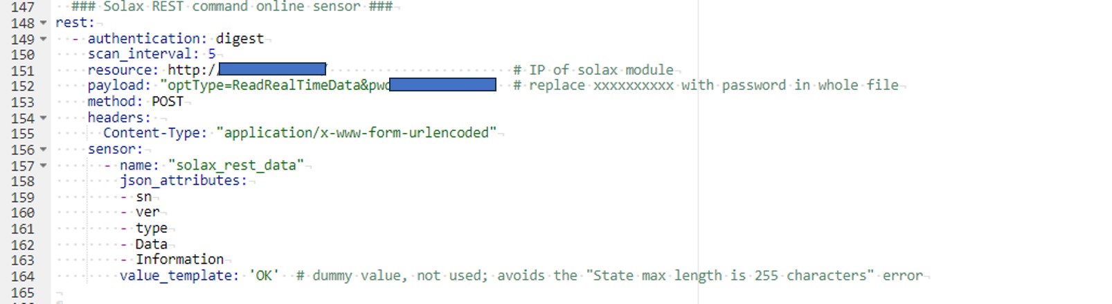

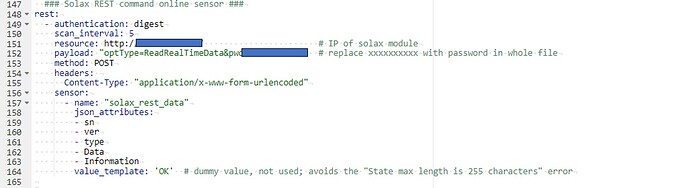

I did swich over to this Homeassistant SolaX modbus integration , but i have a backup:
### Solax REST command online sensor
rest:
  - authentication: digest
    scan_interval: 5
    resource: http://192.168.0.2/                        #IP of solax module
    payload: "optType=ReadRealTimeData&pwd=SXEYMEEBDR"   #replace xxxxxxxxxx with password in whole file
    method: POST
    headers:
      Content-Type: "application/x-www-form-urlencoded"
    sensor:
      - name: "solax_rest_data"
        json_attributes:
        - sn
        - ver
        - type
        - Data
        - Information
        value_template: 'OK'   #dummy value, not used; avoids the "State max length is 255 characters" error

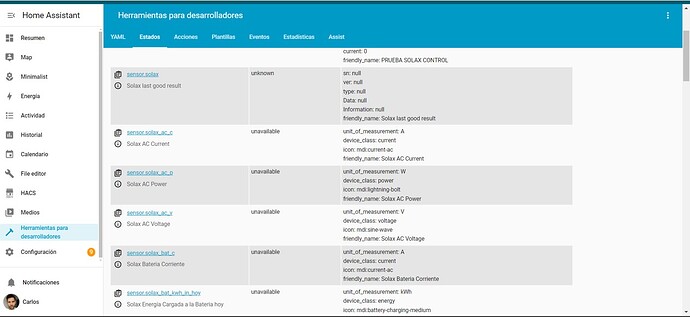

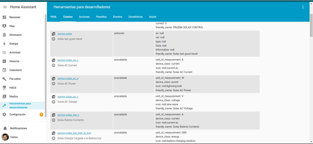

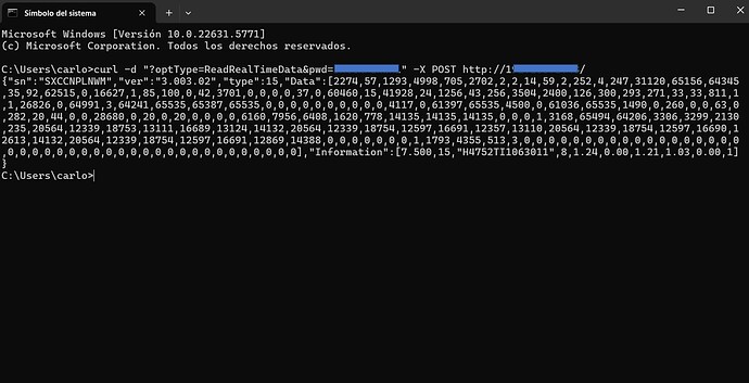

Hello everyone,
I have a set of REST and template sensors in Home Assistant that monitor my Solax inverter. These sensors were working perfectly until I recently updated Home Assistant to version 2025.7.1 and continues in 2025.8.3
The REST sensor queries the inverter at http://192.168.1.48/ and the inverter always responds with valid JSON when I test it using curl:
curl -X POST -d "optType=ReadRealTimeData&pwd=XXXXXXXXX" http://192.168.X.X/
Sample response:
{"sn":"SXCCNPLNWM","ver":"3.003.02","type":15,"Data":[...],"Information":[...]}
Despite this, in Home Assistant sensor.solax now remains null, and the log repeatedly shows:
REST result could not be parsed as JSON
I am including the REST sensor in sensors.yaml like this:

I have many template sensors that depend on this REST sensor’s attributes, for example: state_attr('sensor.solax_rest_data', 'Data')[0].
I have tried moving the REST sensor between configuration.yaml and sensors.yaml, adjusting json_attributes_path, and changing scan_interval, but nothing seems to work.
Has anyone encountered a similar issue with Solax inverters after a Home Assistant update? How did you fix the JSON parsing or REST sensor integration so the template sensors could work again?
Thanks in advance!

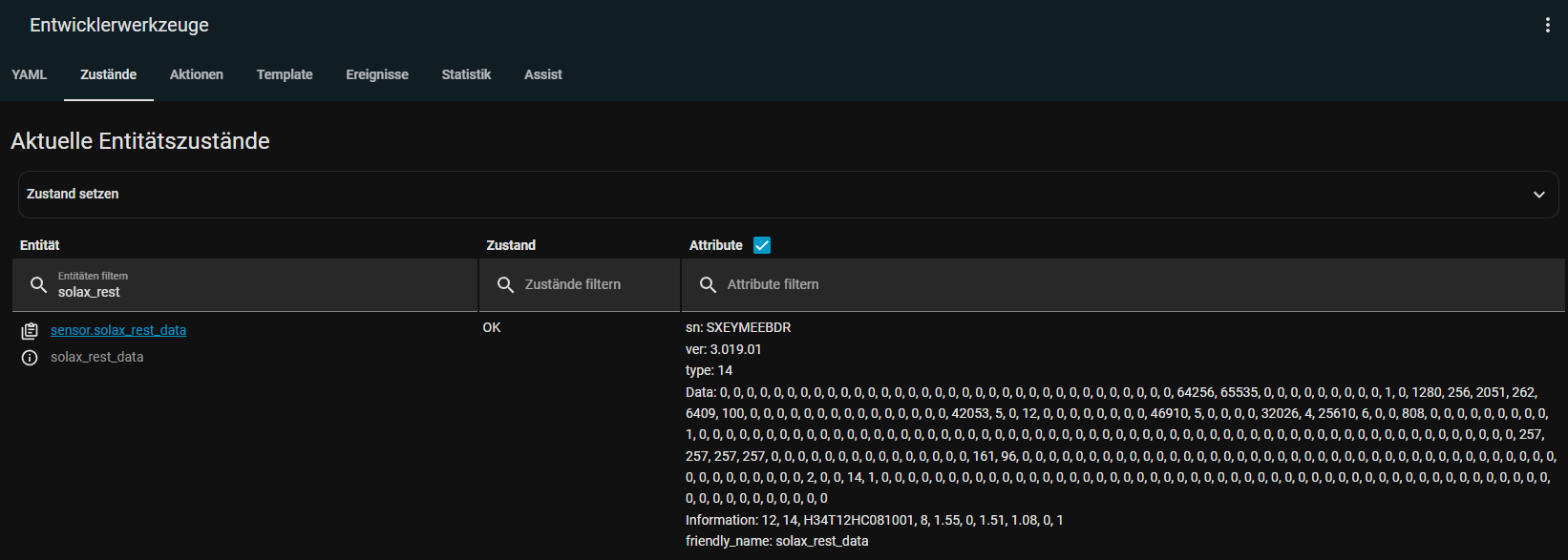

i am not using this anymore, as i the rs485 modbus is much more reliable, so i added the rest sensor for testing and it still works, i just added the setup to the end of my configuration.
Do you get data into your rest sensor? You can check that easily in the developer tools:
Thats the config i used, looks complete different than your setup, i didn’t review if your syntax could be correct or not:
  ### Solax REST command online sensor ###
rest:
    scan_interval: 5
    resource: http://192.168.0.2/                       # IP of solax module
    payload: "optType=ReadRealTimeData&pwd=MYPWD"  # replace xxxxxxxxxx with password in whole file
    method: POST
    headers:
    sensor:
        json_attributes:
        - sn
        - ver
        - type
        - Data
        - Information
        value_template: 'OK'  # dummy value, not used; avoids the "State max length is 255 characters" error
Thank you for de answer.
I check my configuration and it looks pretty similar to yours. I’ve just added the authentication line to mine.
No, I don’t receive the rest data anymore. As you can see the atributes are missing. When I go to the log a get this error:
Registrador: homeassistant.components.rest.util
Fuente: components/rest/util.py:37
integraciĂłn: RESTful (documentaciĂłn, problemas)
OcurriĂł por primera vez: 09:56:56 (56 ocurrencias)
Última vez registrado: 10:01:33
It seems like I don’t receive rest data anymore. It suddenly happened with the upgrade to version 2025.7.1.
I don’t get what the problem is…
SOLVED.
I deleted headers: Content-Type: “application/x-www-form-urlencoded”
and now it works
