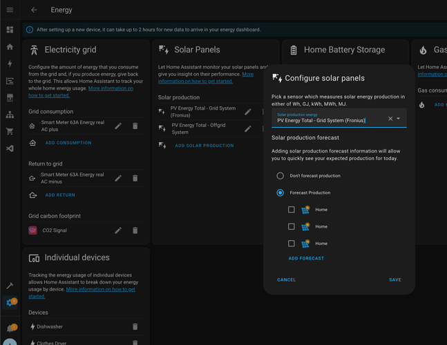

I am new in to HA, and have just imported the API from Solcast.
How do I get the display like you have in this image…?
Thanks
this looks realy nice :smiley:
Anyway i have a strange problem.
Maybe you can help out.
grafik
The NA Entities are avileable if I click on them.
Any ideas why its not displaying right?
It’s in the setup of the Energy Dashboard.
Settings / Dashboards / Energy
Then when you enter in details of your Solar PV array you can configure a solar forecast for it:
