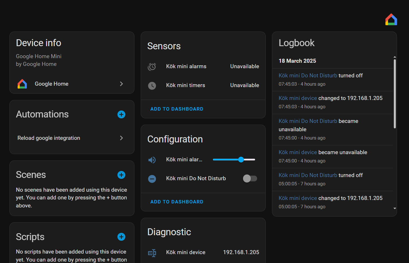

Is the Google Home plug-in still working? I can’t seem to get it started. When I go to set it up it using my Google ID and an App password it fails to connect and the log shows…
2025-03-18 10:38:46.577 ERROR (SyncWorker_8) [glocaltokens.client] [!] Could not get master token.
2025-03-18 10:38:46.579 ERROR (MainThread) [custom_components.google_home] Failed to get master token
  File "/config/custom_components/google_home/config_flow.py", line 138, in _get_master_token
    master_token = await client.async_get_master_token()
  File "/config/custom_components/google_home/api.py", line 81, in async_get_master_token
    raise InvalidMasterToken
custom_components.google_home.exceptions.InvalidMasterToken
It seems to work for me. But I’m not on the latest version of HA.
Thanks - it does indeed work… but getting the Master Token is quite complex! All sorted now.
