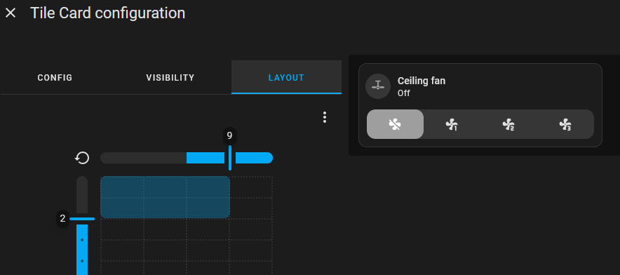

Hi all, I’m trying to organize my dash panels a little nicer using grids, horizontal + vertical stacks and what not.
Using the new tile support for fans, I’d have the fan tile use two-thirds of the horizontal space and the last third of the space by a Light tile as they both look better with that kind of allotted screen real-estate, but I’m running up against a problem here:
TLDR; I can do this with a horizontal stack or two column grid:
…or this with a 3 column grid:
But how would I do this: (pardon the crappy 10 second mspaint mockup)
I cannot rule out the solve might be laughing right in my face, nor am I against HACS special cards if there is such, yet I’ve not found one as of yet. Any suggestions are welcome.
