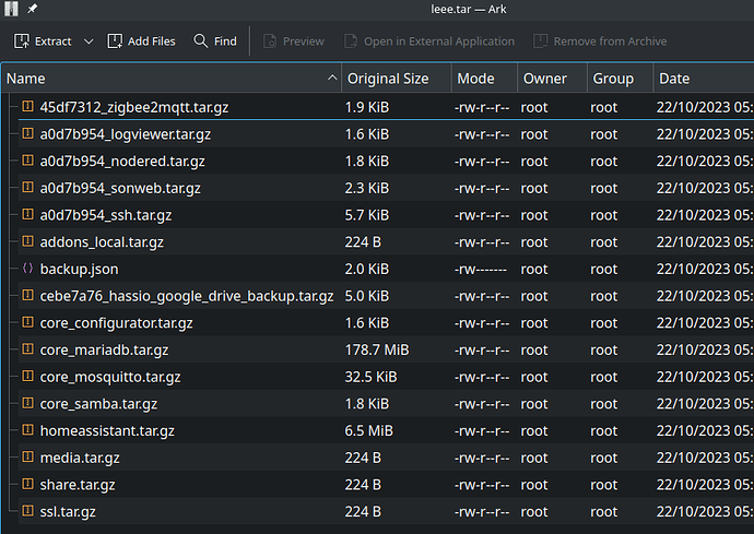

Try to open the backup to see if there is a homeassistant folder included.
Sometimes the backup does not finish correctly, so trying to install a backup file from such an event will always fail.
You can often use a zip program to open the files.
I use 7-zip, but WinZip or WinRAR should work too.
I think it is complete.
Yeah, it looks complete.
