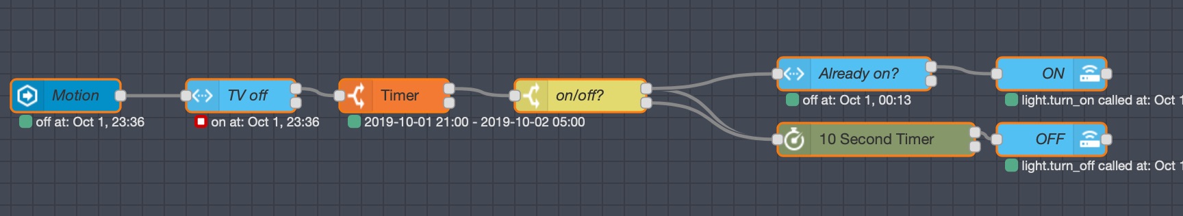

Is it possible to check a current state of a node without passing that on as the payload? I’m trying to set up a motion sensor event state node as the trigger and have it check the current state of the TV (TV must be off) before continuing. The problem is I need both the on and off from the motion sensor to pass through to flow as they happen but the current state node keep passing its current state. I’d like the current state node just to act as a check and not pass that data on.
[{"id":"a672553e.2455c8","type":"server-state-changed","z":"2830869c.46727a","name":"Motion","server":"e8627faa.c1d02","version":1,"entityidfilter":"binary_sensor.great_room_motion","entityidfiltertype":"substring","outputinitially":false,"state_type":"str","haltifstate":"","halt_if_type":"str","halt_if_compare":"is","outputs":1,"output_only_on_state_change":false,"x":70,"y":2080,"wires":[["cf9ecdb0.80edd"]]},{"id":"7a04ed8a.a8cd14","type":"api-call-service","z":"2830869c.46727a","name":"ON","server":"e8627faa.c1d02","version":1,"service_domain":"light","service":"turn_on","entityId":"light.foyer_light","data":"","dataType":"json","mergecontext":"","output_location":"payload","output_location_type":"msg","mustacheAltTags":false,"x":970,"y":2060,"wires":[[]]},{"id":"32cf9924.7114ae","type":"switch","z":"2830869c.46727a","name":"on/off?","property":"payload","propertyType":"msg","rules":[{"t":"eq","v":"on","vt":"str"},{"t":"eq","v":"off","vt":"str"}],"checkall":"true","repair":false,"outputs":2,"x":540,"y":2080,"wires":[["1e66f7a3.7680a","80207e2a.1cc05"],["1e66f7a3.7680a"]]},{"id":"7cc06474.7570e4","type":"api-call-service","z":"2830869c.46727a","name":"OFF","server":"e8627faa.c1d02","version":1,"service_domain":"light","service":"turn_off","entityId":"light.foyer_light","data":"","dataType":"json","mergecontext":"","output_location":"payload","output_location_type":"msg","mustacheAltTags":false,"x":970,"y":2120,"wires":[[]]},{"id":"1e66f7a3.7680a","type":"stoptimer","z":"2830869c.46727a","duration":"10","units":"Second","payloadtype":"num","payloadval":"0","name":"","x":810,"y":2120,"wires":[["7cc06474.7570e4"],[]]},{"id":"80207e2a.1cc05","type":"api-current-state","z":"2830869c.46727a","name":"Already on?","server":"e8627faa.c1d02","version":1,"outputs":2,"halt_if":"off","halt_if_type":"str","halt_if_compare":"is","override_topic":false,"entity_id":"light.back_patio_light","state_type":"str","state_location":"payload","override_payload":"msg","entity_location":"data","override_data":"msg","blockInputOverrides":false,"x":790,"y":2060,"wires":[["7a04ed8a.a8cd14"],[]]},{"id":"c1aefd5b.8573d","type":"time-range-switch","z":"2830869c.46727a","name":"Timer","lat":"41.51528","lon":"-83.68148","startTime":"21:00","endTime":"05:00","startOffset":0,"endOffset":0,"x":370,"y":2080,"wires":[["32cf9924.7114ae"],[]]},{"id":"cf9ecdb0.80edd","type":"api-current-state","z":"2830869c.46727a","name":"TV off","server":"e8627faa.c1d02","version":1,"outputs":2,"halt_if":"off","halt_if_type":"str","halt_if_compare":"is","override_topic":true,"entity_id":"media_player.panasonic_viera_tv","state_type":"str","state_location":"payload","override_payload":"msg","entity_location":"data","override_data":"msg","blockInputOverrides":false,"x":230,"y":2080,"wires":[["c1aefd5b.8573d"],[]]},{"id":"e8627faa.c1d02","type":"server","z":"","name":"HA Fahrer","legacy":false,"hassio":true,"rejectUnauthorizedCerts":true,"ha_boolean":"y|yes|true|on|home|open","connectionDelay":true}]
