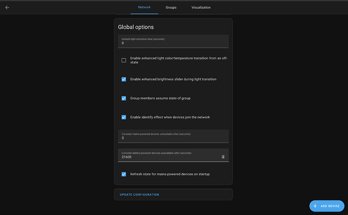

You can change it in ZHA if you click on Configure, and scroll to the bottom, I set mine to 5 seconds for the NON-Battery ones
