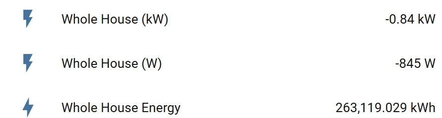

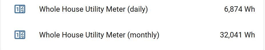

Hi all, I’m going a little crazy here and I’m sure I’m just missing something simple. I have various power meters, and they all measure in W. For my utility meters, I fork them off and calculate kW to feed into integrations → utility meter. I do this for two items: my “whole house”, and my “EV charger”.

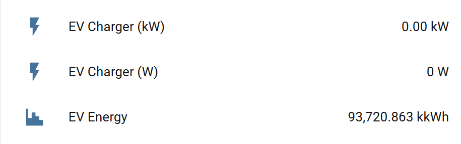

Even though they are both setup identically (I think…) the EV displays as W not Wh.
The values themselves are off because I haven’t found a way to reset the integrators after changing the units. I may just have to give them a new name/uniqueID and start over. So forget the units themselves for now (unless you notice something I’m doing wrong!!).
(above) House is as expected, an energy measurement. EV is a power measurement.
(below) House looks good. ignore the values (negative is from solar). EV energy changed the icon and has a werid unit (?)

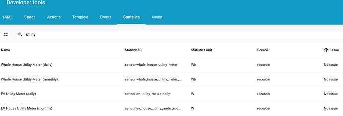

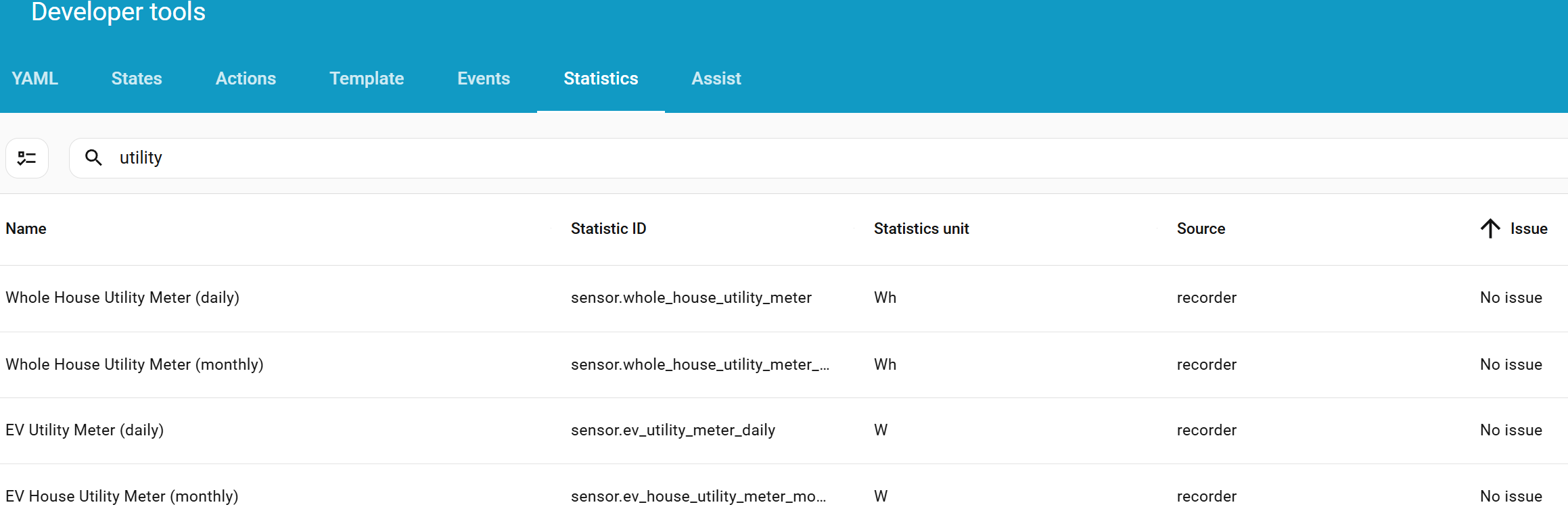

EDIT:
poking around in the Developer Tools shows me that its wrong:
