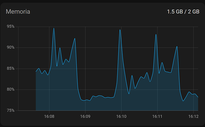

Recently I’ve been getting collect2: fatal error: ld terminated with signal 9 [Killed] frequently when building with dashboard addon on my HA machine. Google search results indicate root cause is running out of RAM in build environment. I’ve had some luck restarting the add-on container and rebooting the host to get the everything to build but still get the error sometimes on first build after a full reboot so it has been pretty frustrating.
I couldn’t install or allocate more RAM on my current HA setup, so I ended up installing esphome on another linux virtual machine and building my projects via the command line. I was using the samba share addon to access the HA /config/esphome/ on the build machine so the dashboard editor could still be used and to avoid multiple copies of the configuration files.
Also you might want to try building with esp-idf instead of arduino. I haven’t used the BLE tracker much but seemed more reliable to me with esp-idf.

That’s the solution. Thanks @mulcmu!!
I’ve checked the RAM of my system and changing to esp-idf it’s enough, the 2 GB works fine. But in case I need more RAM I can change it in my VM configuration.
