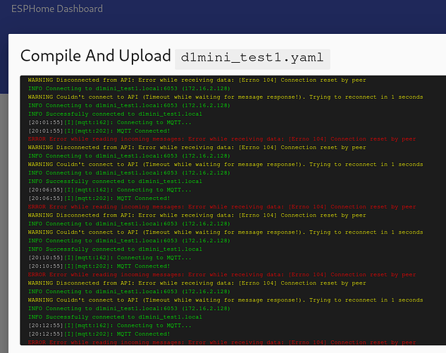

And this is the corresponding ESPHome dash log:
Use the api or mqtt.
Not both. Read the big red box here:

ERROR Error while reading incoming messages: Error while receiving data: [Errno 104] Connection reset by peer
WARNING Disconnected from API: Error while receiving data: [Errno 104] Connection reset by peer
INFO Connecting to d1mini_test1.local:6053 (172.16.2.128)
WARNING Couldn't connect to API (Timeout while waiting for message response!). Trying to reconnect in 1 seconds
INFO Successfully connected to d1mini_test1.local
The device connects to Wifi and to HA via API, then the problems begin.
Thanks,
Piero
