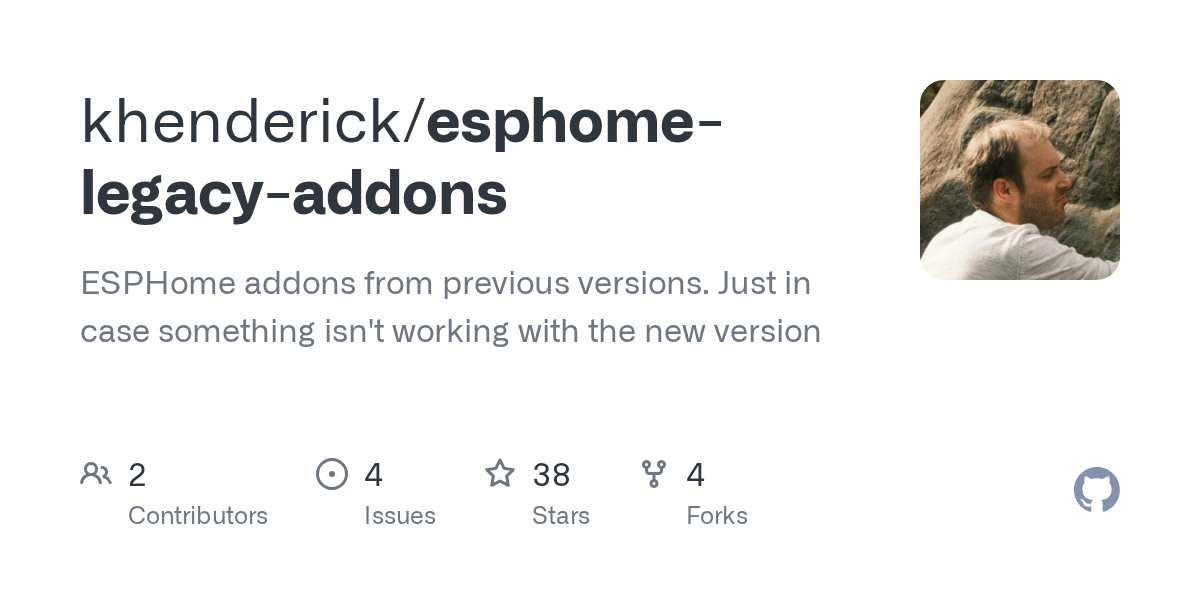

ESPHome is not great as far as rolling back goes. There is an add-on repository with all recent versions, it lets you go back to a previous version for compile:
Legacy ESPHome versions repository
Kenneth Henderick [email protected]

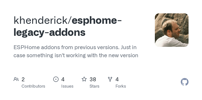

You can. Just compile and install with the previous version.
Install this:
I use 2025.5 for my LVGL projects, I use the latest for new stuff. You can have both installed at the same time.
EDIT: I already linked this repository above BTW…

Go to add-ons, install the version you want from that repository (the latest one will be untouched). Start the add-on and “open Web UI”.
All your yaml will be there, simply “Update” or edit and “Install” the device you are having issues with and it will compile and install that older version.
If you have made changes to the code - that’s your problem I’m afraid - I assume if you did you have a backup of the yaml… :smiley:
