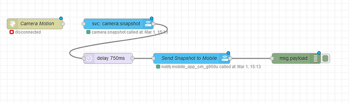

I’ve been using Home Assistant for quite some time now, but I’m only just starting to dive into getting SS and HA connected. I see that there are Actions you can set up within SS to send data to a web hook when motion is detected. This sounds like an absolutely perfect way to trigger a flow in node red to send a snapshot of the motion event to designated mobile devices, but I’m really having trouble getting Node Red to receive info from a web hook. Here’s what I have so far:
I have a Node Red flow set up to listen to the webhook endpoint, then my plan is to set it up so that depending on the payload received, would continue the flow to send the snapshot to mobile.

Got it. Thank you very much for your help.
I was looking for a webhook input node, but there actually wasn’t one within the Home Assistant section, so was using the websocket from input. Your post made me look more into it and found that there were addons that needed updated. After that, webhook node was there and I was able to configure it.
Thank you very much for the images. Helped me out quite a bit.
