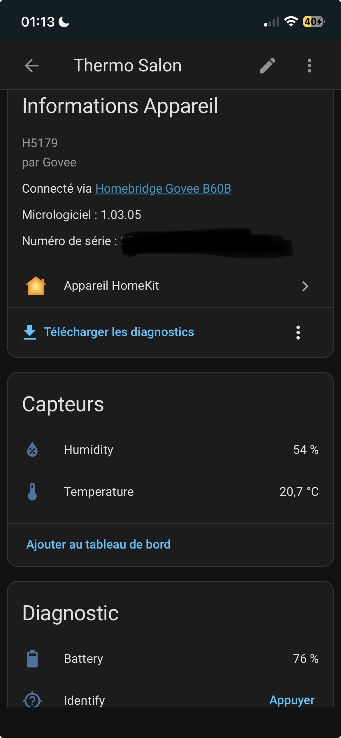

I’m a very beginner but I found by myself an easy way of adding the Govee H5179 in HA.
At first I wanted to add the Govee thermo to Apple home, so I ran Homebridge on docker on my NAS, the Govee plugin give me then the homekit pairing code.
Then the « Homebridge Govee » pop up as an homekit device on HA, just click , add the homekit pairing code and « voilà » !
