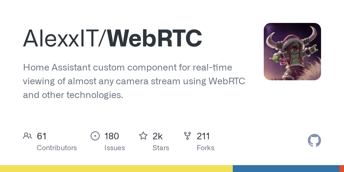

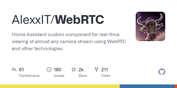

Try the webrtc.dash_cast action. The link is to a custom integration but It should be part of HA now that webrtc is baked in.
