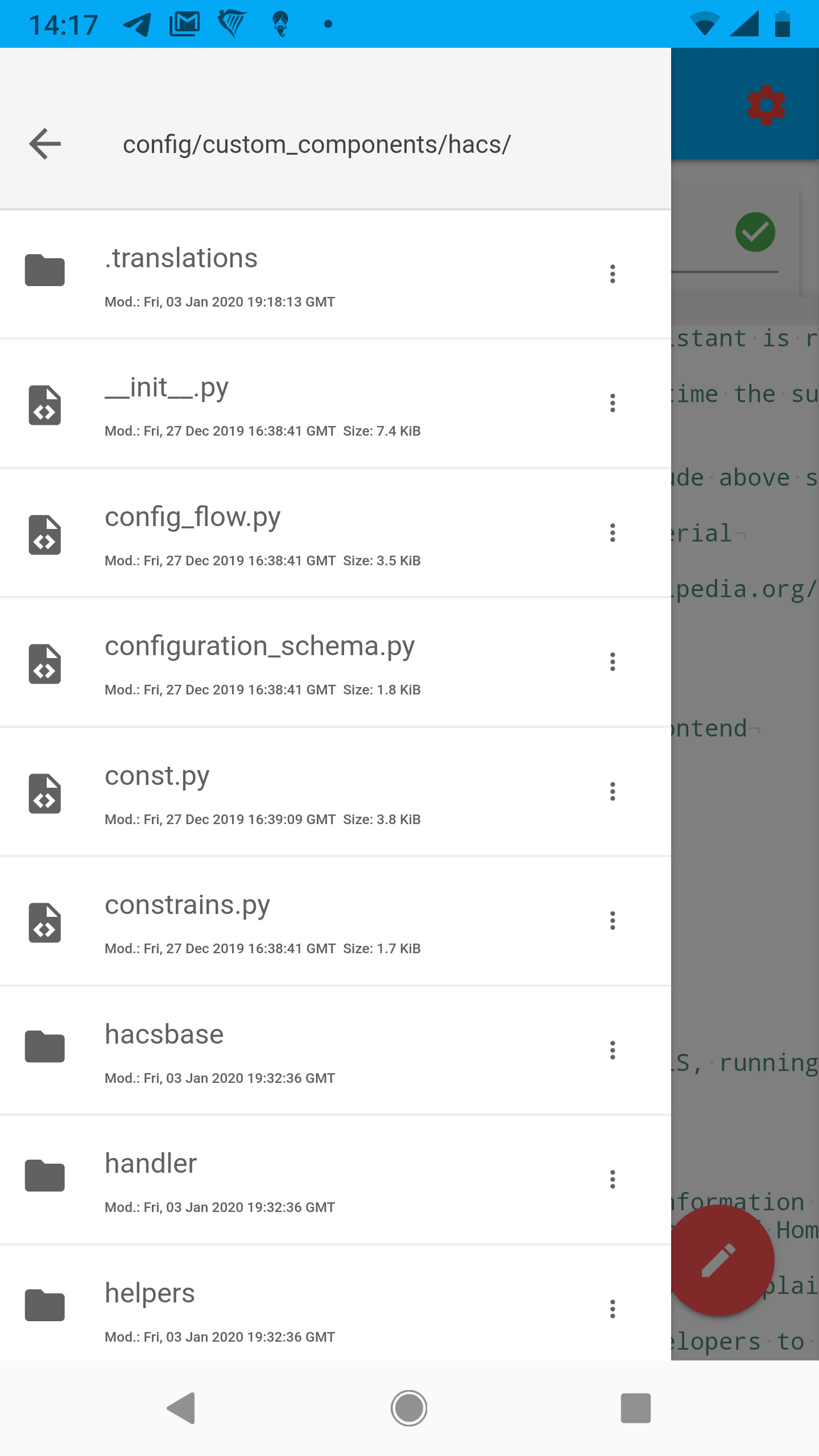

Like this:
Including the hidden .translations directory?

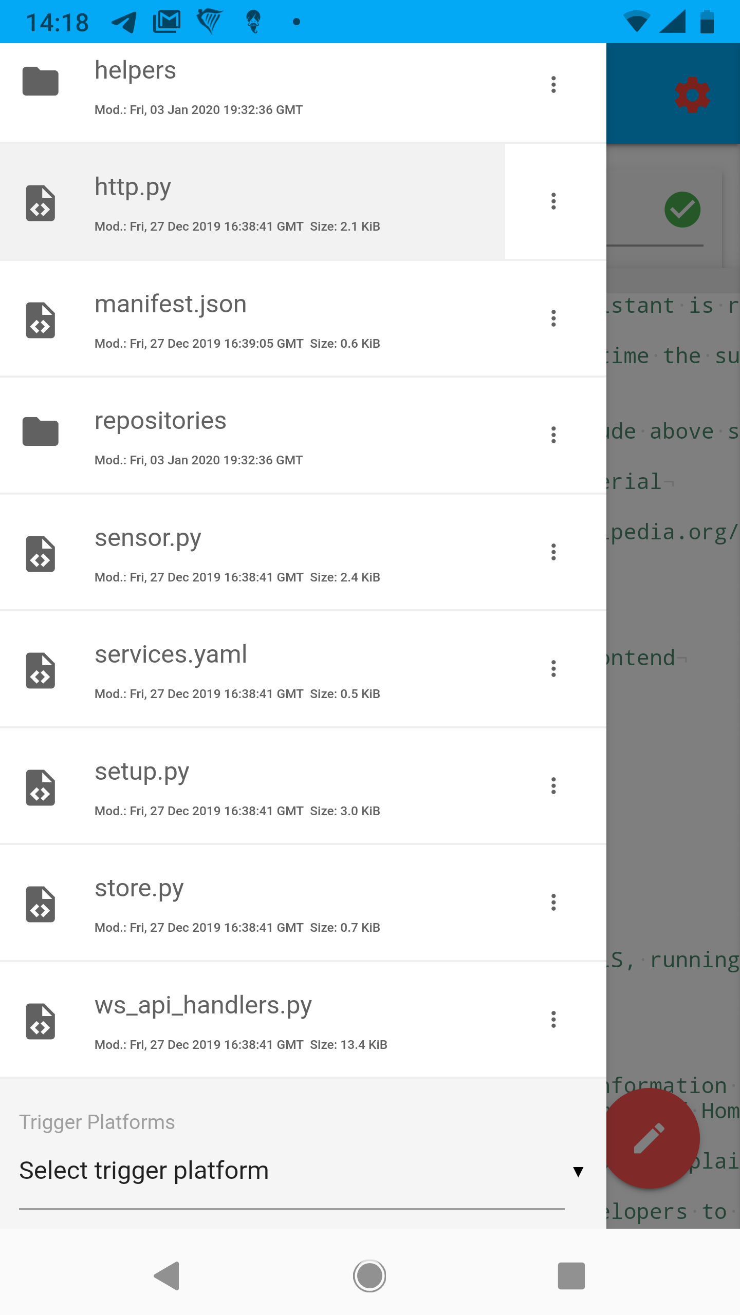

Hello, yes the files are all there. I extracted the * .ZIP folder and copied the resulting “hacs” folder with SambaShare from the PC to the Raspberry Pi …
The “.translation” folder is not hidden from me, see screenshot

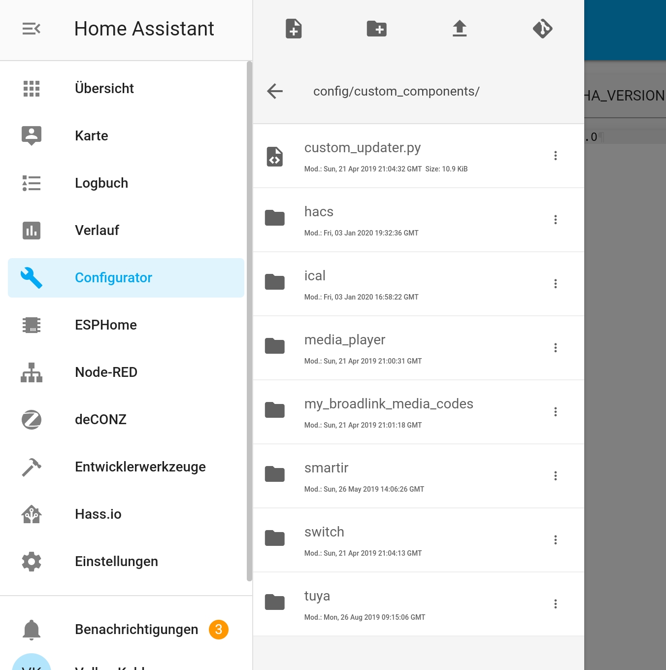

i had the same problem. Solved deleting the custom_updater.py file inside custom_components folder. Have a try
Shame on my head !!! Thank you for your efforts, but I found the problem …
I have just tried to integrate “HACS” for the hundredth time, and carried out all steps as described here … Browser cache cleared, Home Assistant restarted again and again, integrations deleted and reinstalled. My problem was that the file “custom_updater.py” was in the “custom_components” folder !!! I deleted the file and the integration worked, hallelujah !!!
