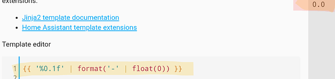

{{ '%0.1f' | format(temperature_text | float(0)) }}
Example
