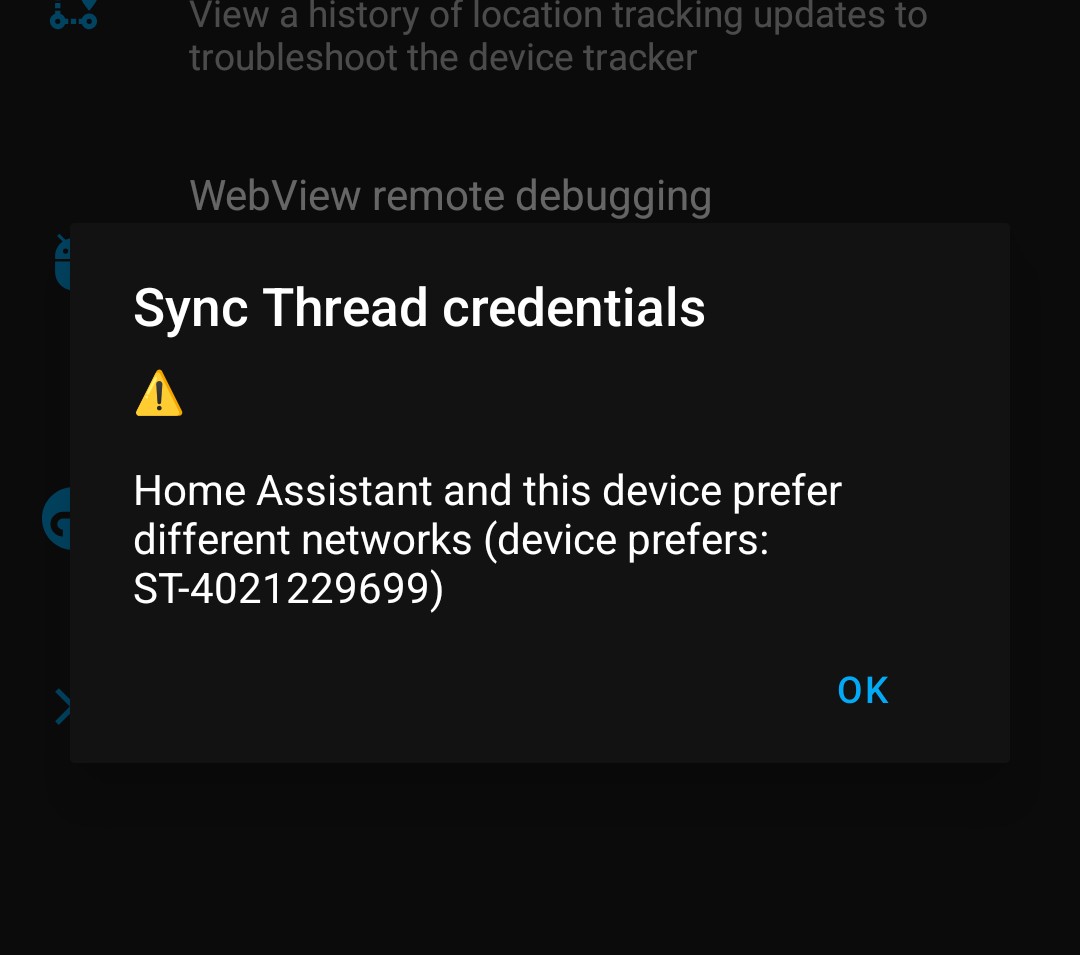

On my phone when I try and use the companion app to sync the creds I get an error saying
Sync Thread Credentials
Home Assistant and this device prefer different networks (device prefers: eero-thread-ce19)
I can’t seem to find a way to change that on my phone. Anyone have any ideas?

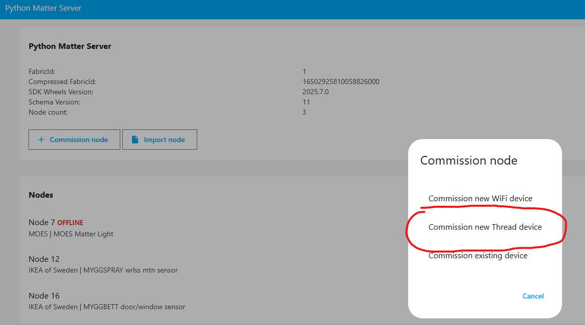

What works fine (and is actually somewhat easier) is to commission device directly through the matter server webui.
You’ll need:
  • The matter server enabled with bluetooth
  • The TRV as displayed in HA Thread integration “info” page
  • The pairing code that goes with the device
Et voila, device integrated…
In this process, the matter server basically replaces the phone.

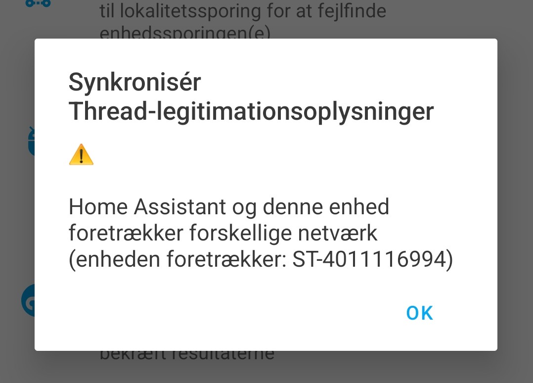

I have same issue. Samsung Galaxy phone and Smart Things Hub alongside with Home Assistant with USB Dongle for Thread.
Seems that no matter what I try , Smart Things hub is preferred Thread Border Router.
Whole Matter system is still far from user friendly promise. I am engineer and I cannot get it to work.
I know I will make it will work - eventually , but this is just crap that will not have chance of becoming main stream until it works flawlessly without so much hassle.

Thank you, this is actually the best solution! I manage 2 different homes with 2 different Thread Networks and I couldn’t connect anything at the 2nd home because my Android phone is stuck on the first home Thread network as Preferred Network.
Using the Matter Server UI allowed me to add a new device to the 2nd home.

Almost the same issue. Smart Things as border router. No Thrads dongle for HA though. All devices (IKEA) connected to Smart Things. Impossible to make HomeAssistant use the ST-xxxx-fabric as preferred network.
