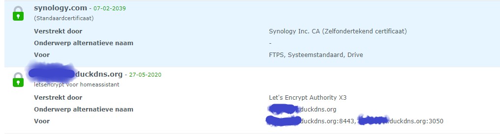

Solved:
Solved : What I did not new I had to add in DSM-certificate that the certificate was provided by Letsencrypt.
Synology automatically filled in it was provided by Synology
How did you add/change the DSM cert? From terminal or the GUI? I am having the same problem.
I added it from the GUI
