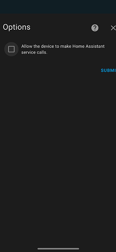

Have you allowed ESPHome to make an API call? I can’t see rest of your yaml but just in case
Many thanks for your answer Julian !
The rest of yaml contains just sensors/switches declaration and nothing more.
Should it contains other (to allow api calls) ?
I can’t find the menu in your screenshot…
How I can allow esphome to make API calls ?
Thanks again
You don’t have to allow that. I think you are confusing this with service calls by ESP devices. That has to be allowed in the menu you showed.
@bubugian that menu is in Settings → Devices & Services → ESPHome (click the ESPHome card title, not the lower devices section.
But as I said this is not your issue.

Wifi signal strength is ok but it is dropping the connection for some reason:
Does your LED have an appropriate current limiting resistor?
It’s the onboard LED, so resistor is by design.
Maybe this ESP8266 has some problem. I’ll try with a new one.
I’ll be back soon.
EDIT
I try with 2 new ESP8266 boards. No changes.
So, in order to avoid power consumption peaks or GPIO misunderstandings, I try to comment the LED gpio definition and LED blink routine (it has never worked).
No changes again: result is the same ‘connection reset’
I try disabling the “manual IP” section allowing the IP address to be assigned by the router and… BINGO! It works!
So, I’ve understood that the issue was a network configuration problem and upon investigating, I realized I had a big mistake with the subnet mask.
It was 255.255.255.252 instead of 255.255.252.0..
Thanks all for the help and sorry for the mistake !
