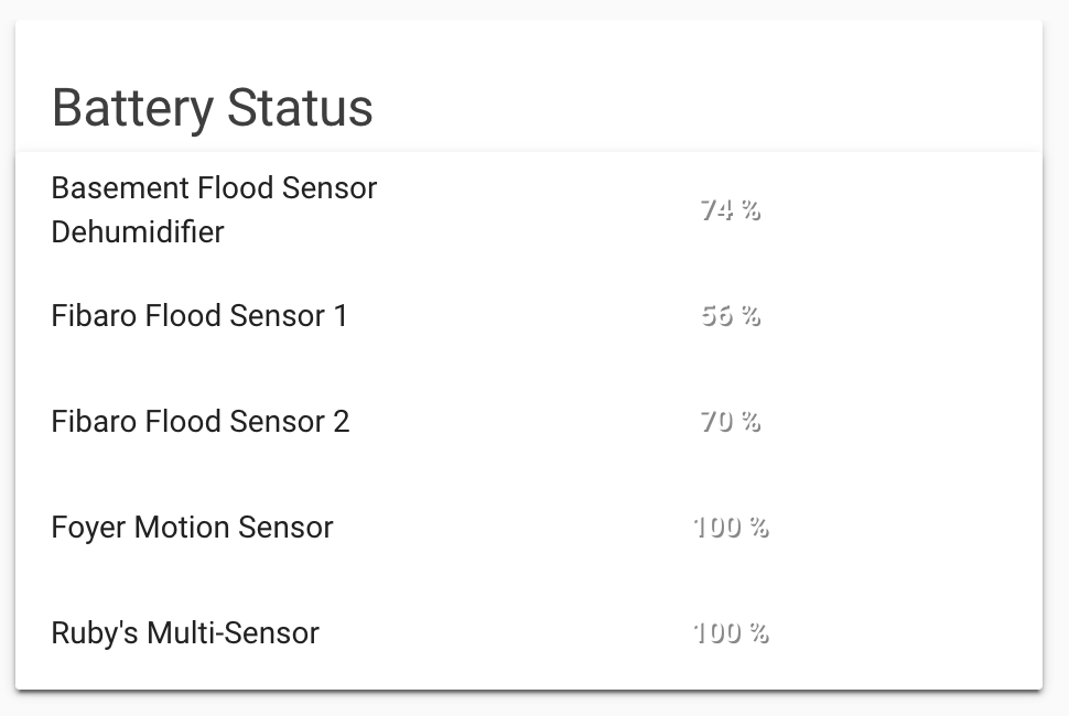

I’m not able to get the Bar Chart to work within a lovelace card and looking for some help.
The following is what is shown in the dashboard, and notice there are no bars :slight_smile:
This is the configuration I have:
cards:
  - card:
      attribute: battery_level
      columns: 1
      severity:
        - hue: '0'
          value: 50
        - hue: '40'
          value: 75
        - hue: '120'
          value: 100
      title_position: left
      type: 'custom:bar-card'
      unit_of_measurement: '%'
      width: 60%
    filter:
      include:
        - attributes:
            battery_level: <=100
    type: 'custom:auto-entities'
title: Battery Status
type: 'custom:vertical-stack-in-card'
What’s wrong with the config that the bars aren’t showing up?

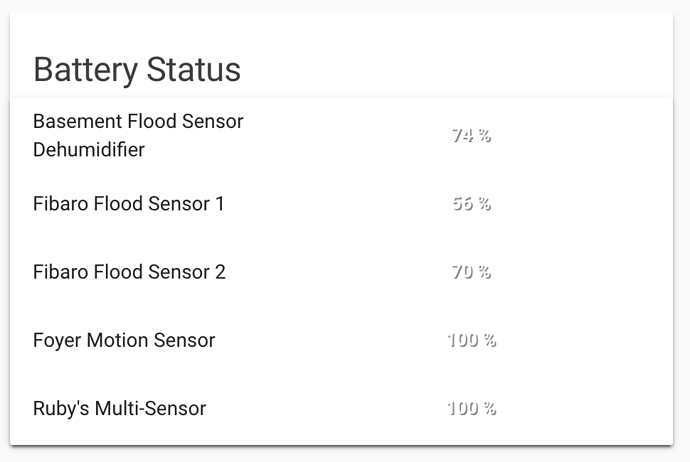

Result:

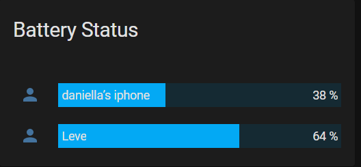

I’m trying your code, but i only get one value, and thats my vacuum… all buttons. motion sensors, magnet sensor etc are not listed… any tips?
When i use your code, i get this (see image), not color formatted and the edges are not rounded, and only 2 items show up…
Can you share you styling code as well?
Does your auto-entities populate all battery levels, or how did you all of yours to show?
