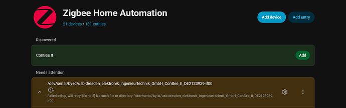

this is the error I’m getting in the frontend when I run the container:

What do I need to change to make it recognize my device?
Use docker exec to enter the container and see if the mapped drive (/dev/serial/by-id/usb-dresden_elektronik_ingenieurtechnik_GmbH_ConBee_II_DE2123939-if00) is showing up inside your container.
If it is there then I’m afraid I can’t help why it isn’t working :frowning_face:.
If it is not there then there may be a problem mapping it to the “/dev/serial/by-id” subdirectory. Try mapping to a simpler name directly in /dev - something live /dev/zigbee should work - and then update your configs to use “/dev/zigbee” for the coordinator device.
what environment is your docker running in? Ubuntu, proxmox, Nas,…?
when I tried this there was no /dev/serial at all (no clue how zwave was working with this being the case). And strangely when the container was running,
disappeared from the host machine as well (and came back as soon as I stopped the container).
When I tried mapping the devices directly:
      - /dev/ttyACM0:/dev/ttyACM0
      - /dev/ttyACM1:/dev/ttyACM1
zha would prompt me to migrate my adapter, but then I’d end up with this error:
The adapter you are restoring to does not properly support backup restoration. Please upgrade the firmware.
Error: Please upgrade your adapter firmware. Firmware version 0x264a0700 does not support writing the network key frame counter, which is required for migration to succeed.
docker host is gnu/linux: Linux 6.17.8-arch1-1 #1 SMP PREEMPT_DYNAMIC Fri, 14 Nov 2025 06:54:20 +0000 x86_64 GNU/Linux
I suspected that the problem was udev related but wasn’t sure. Based on what you see I’m fairly certain that it is.
The reason “/dev/serial” doesn’t exist at all is because it isn’t actually part of the baseline /dev structure. It is created by udev when a serial device is plugged it to create meaningful names for the devices.
Unfortunately, docker containers don’t (normally) support udev. So there is nothing there to recognize that a device has been plugged in and no udev trigger to create the symlinks with the more rational names. That’s why you need to map the actual device (/dev/ACMx) to a device directly in /dev.
Now - second question - ZHA thinks you need to do a migraton. That is because the USB device name changed. I don’t use ZHA (Z2M works so much better for me :slight_smile:). But google suggests that the path for the co-ordinator can be found in your Home Assistant configuration in
“/config/.storage/core.config_entries”. If you edit that file and change it to the name you end up mapping in /dev it should solve your problem. Maybe…
Thanks for walking me through that, it makes complete sense now.
After updating the config_entries file with the direct path to the device, all my zha integration is again functional.
Thank you!
