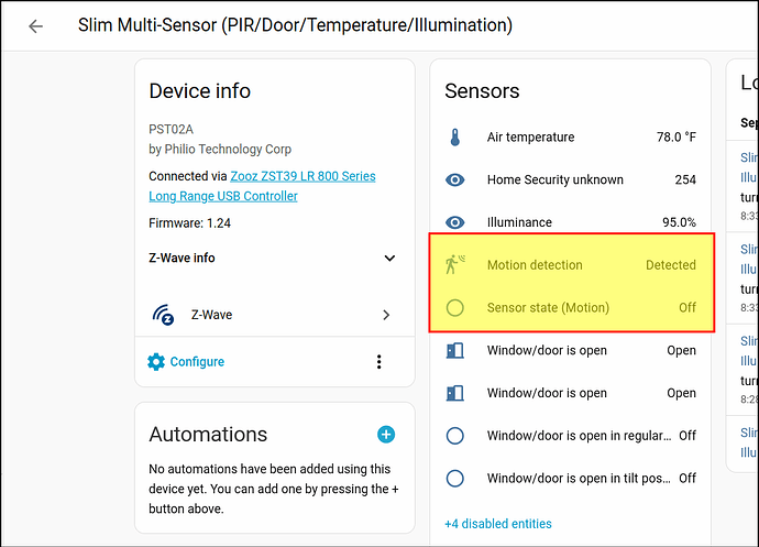

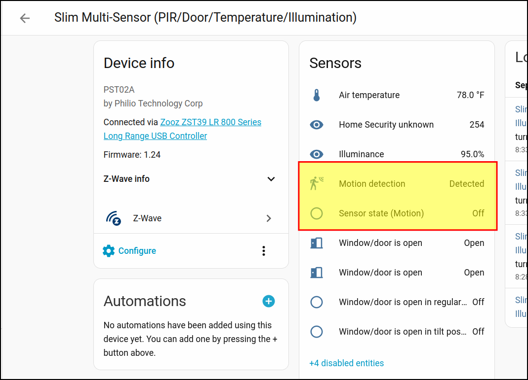

For my setup I have found that one of the disabled entities ā€œSensor State (motion)ā€ after enabling reports motion the way that I think it should and seems more useful than the ā€œMotion Detectionā€ sensor which always says Detected.
