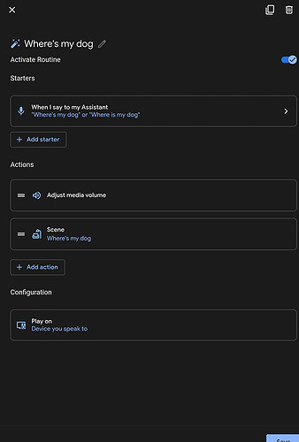

Hey, julian.
It’s working on all devices that are viewed as speakers.
My script:
alias: Where's my dog
mode: single
sequence:
  - data:
      entity_id: media_player.all_but_bd2
      message: The dog is in the {{ states('sensor.dog_area') }}
    action: tts.google_translate_say
  - delay:
      hours: 0
      minutes: 0
      seconds: 5
      milliseconds: 0
  - action: media_player.volume_set
    metadata: {}
      volume_level: 0.2
description: ""
On your specific case you can ignore everything from “delay” and “action”.

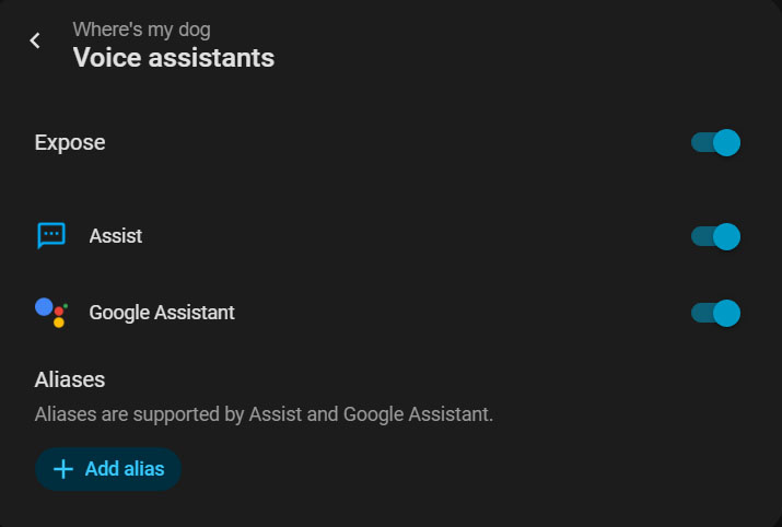

Then you have to expose the script to Google Assistant:

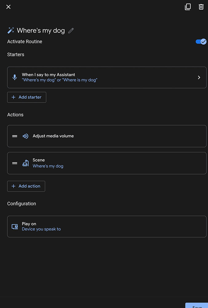

Finally, on Google Home you create the automation:
Hope it helps.
