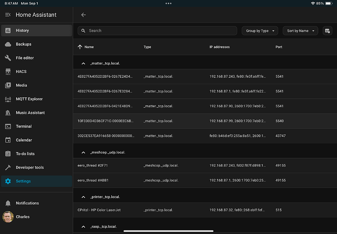

I am looking for some assistant with commissioning my first Matter device. I have a Smartwing PoE shade installed. I have gone through the pairing steps multiple times. I have verified that ipv6 is enabled and that mDNS is working. My network is two eero Pro 6e TP-Link Sg1428pe with one default vlan.
I can see the Matter device advertising using the Zeroconf browser in Home Assistant.
Here is the “Matter” portion of the diagnostic download. Any help on what to try next would be appreciated.
