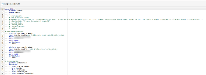

Ok, so it actually points to the sensors.yaml file.
Here is its contents:
The very first line does not belong there (the command line integration). Delete it.
The commented out binary sensor does not belong there either.
Indeed, I switched the 1st command line in the configuration.yaml and everything seems OK now, thank you!
