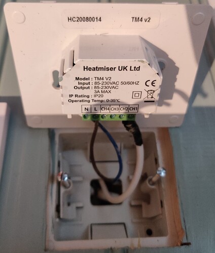

The boiler control unit is the one in the picture below.
The brown and blue wires are supplying 240VAC to this unit.
The white cable is the one coming from the thermostat in the living room.
I thought this kind of wiring was more or less standardised. I’ll try to dig more info on how this was done.
As far as I understand you have two thermostat chained the TM4 and the mechanical one.
If i understand correctly the white wire is connected from CH3 or 4 of TM4 when switched on closes the relay.
After that the signal goes to the mechanical thermostat that if is the case closes the contact giving the consensus to boiler.
Why having that chain, I can’t say…
The only advantage I see is the TM4 has time programs, but as you are using only one channel why don’t you move and remove one of the two thermostat as these are chained and if both are not “ON” you won’t get heating.
I believe you need to investigate :grin: too many thermostat for one circuit.

The white wire is connected to TM4’s CH1. According to the Q&A in the TM4’s official documentation (4 Zone Time Clock Programmer - Heatmiser TM4-TS) it only offers time clock outputs.
I suppose I better call up the electrician who wired my house…
I got it sorted. It appears one of the neutral cables was not connected and it was throwing everything off… Go figure!
