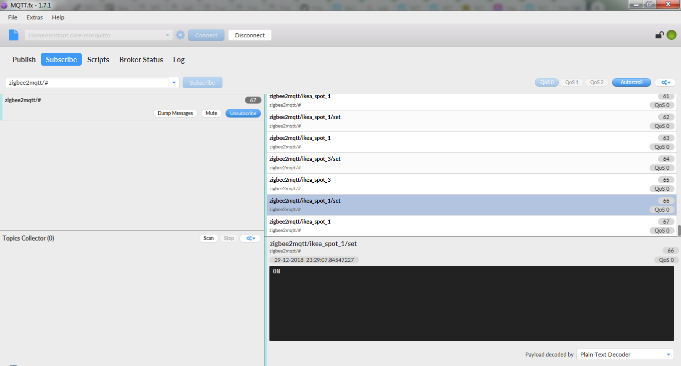

This does give me the option to turn the light on, which it does. But then the interface does not recognize it. Also, it does not give an option to set the brightness or the color_temp.
When I’m watching the state_topic on an external mqtt watcher I do see it does post the differences, so I think it is the correct topic.
So, zigbee2mqtt/ikea_spot_1 tells me: {"state":"ON","brightness":100,"color_temp":400}.
On the discord channel @tinkerer told me that:
That’s a JSON payload containing the state, not the actual state, that’s the problem
How do I fix this?
