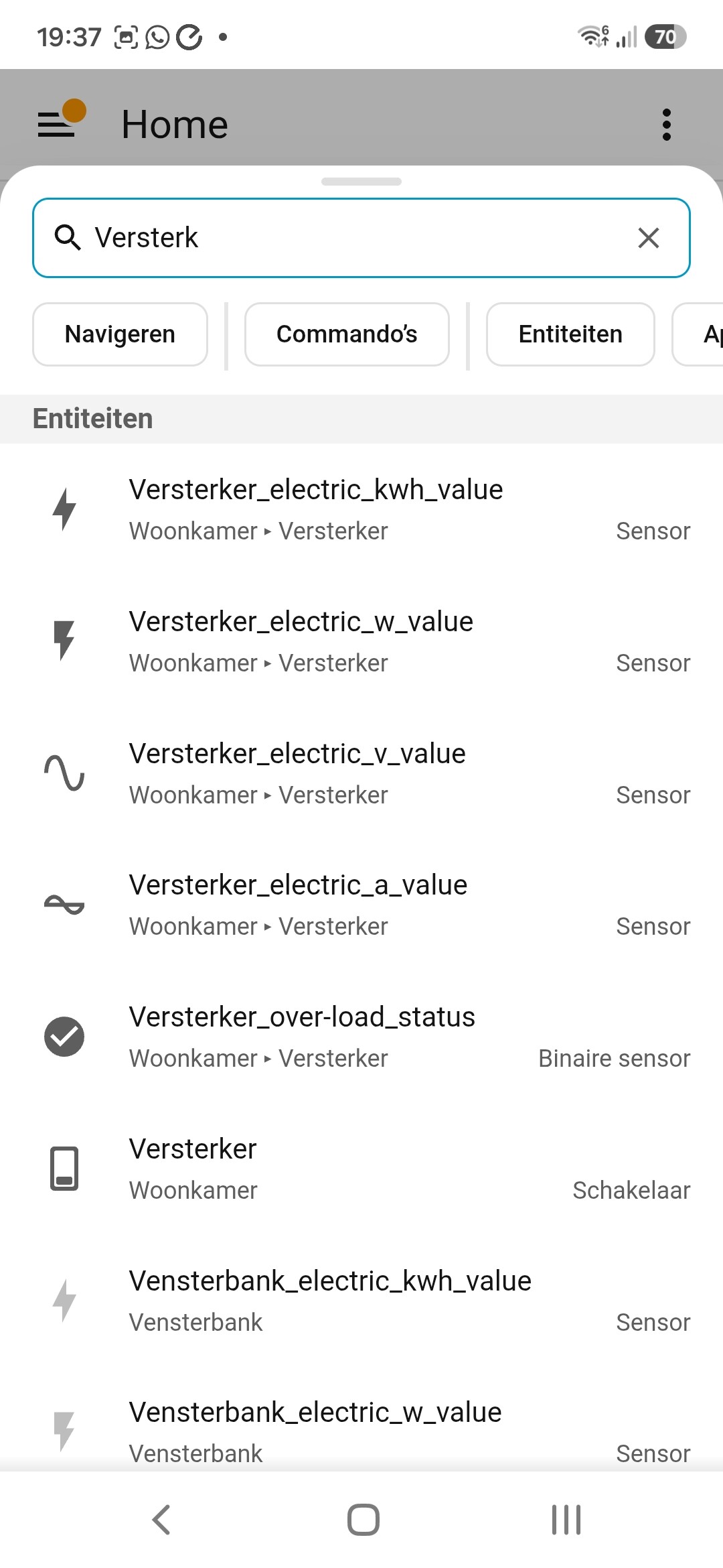

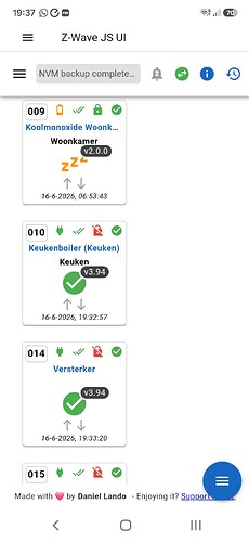

Now some devices and their entities show in the dashboard (and work, like the example "versterker") and other are not in the dashboard and not published to google home. When i go in zwAve js ui to the entity and enter a value, they still take that. For instance i can set a dim level for a lamp.
In the dashboard there was a heap of entities broken that I cleared up.
Any help how to being those entities back with the correct "gui" parts?
